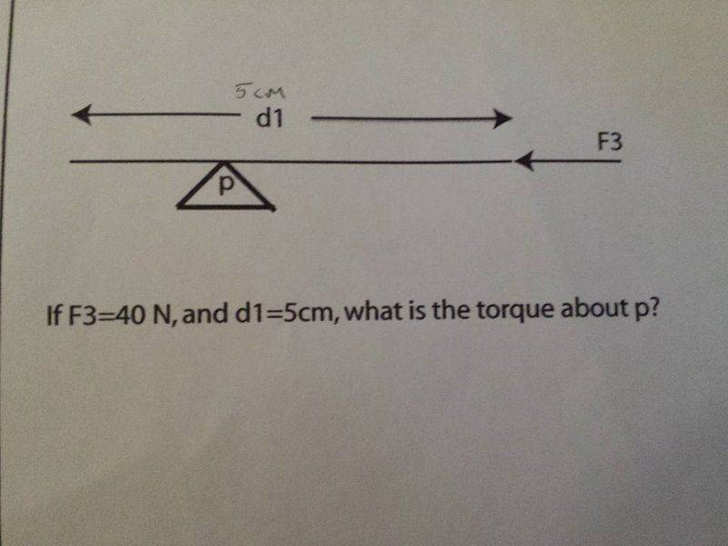

thank you! and just one more question - slightly related to torque equations in general. When the force is exerted in that direction, it is considered a moment and therefore equal to 0 correct? Because no actual force is exerted on that line? So I would then think that the torque about p would be zero.
The lever arm is the perpendicular distance from the pivot point to the line of action of the force. In this case, the line of action of the force passes through p, so the lever arm and thus the torque is zero. Force is exerted, of course, but no torque.
