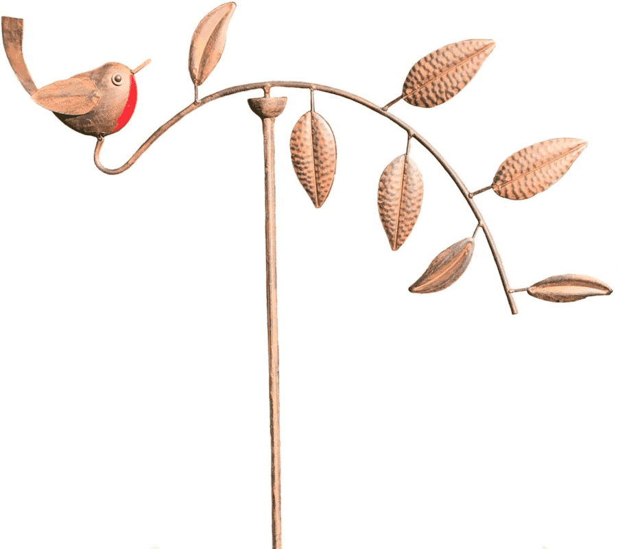

A.T. said:
This is nice! When I was a bit smaller, something that confused me was that you come across these sorts of ornaments in garden centres and whatnot
that are in stable equilibrium. Without that small vertical piece, tilting the thing on the top by an arbitrary angle would contract the perpendicular distances of the centres of mass of either side to the axis by the same fraction, and the ornament would remain in its new equilibrium position (i.e. neutral equilibrium). But the vertical piece destroys that symmetry, as demonstrated in your video, and ensures that there is actually a restoring torque!
