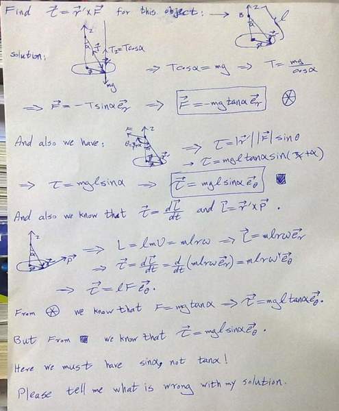

hi rado5! :smile:
(have an alpha: α and an omega: ω and a tau: τ :wink:)

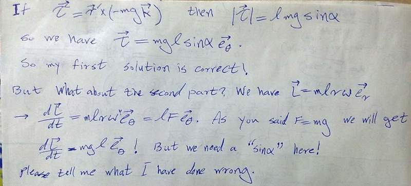

to clarify: is this a mass m on a string of length l and tension T rotating at angle α with angular velocity ω?
or is there also a horizontal cable with tension F? :confused:
assuming the former, you've calculated τ (about the vertical axis) using the wrong force …
τ is r x -mgz, not r x F
(T and F don't count because they go through the vertical axis; F also doesn't count if there's no horizontal cable, because then you just invented F) :wink:
Hi tiny-tim!
Thank you very much for your kind help.
Yes, this is a mass m on a string of length l and tension T rotating at angle α with angular velocity ω.
hi rado5! :smile:
i'm getting confused … it would be easier if you typed your answer, instead of giving us a photo of your handwriting
you're trying to do τ = r x Fnet = dL/dt
but about the vertical axis, L is constant, and τ is zero
we solve this sort of problem with the ordinary linear F = ma equation​

There are two problems in my book. The first one is an example with its solution. As I told you before the solution is [tex] \vec{\tau}=mglsin\alpha \vec{e_{\theta}} [/tex] for the problem [tex] \vec{\tau}= \vec{r} \times \vec{F} [/tex]. The second one is a problem with no solution which asks "Is [tex] \vec{\tau}= \frac{d\vec{L}}{dt} [/tex] correct for [tex] \vec{\tau}= \vec{r} \times \vec{F} [/tex] in the first example". I have been trying to show that it must be correct. I mean I have to show that [tex] \vec{\tau}= \vec{r} \times \vec{F} = \frac{d\vec{L}}{dt} [/tex].
oh i see now!
the confusion is that you're not treating τ and L as vectors
your τ is calculated about the top of the string, and is r x -mgz,
with (as you say) magnitude mglsinα, and direction tangential
your L (calculated about the top of the string) is r x v, which is sticking up diagonally outward
L's vertical component is constant, so you need only bother with d/dt of its horizontal component …
that should give you the required τ = dL/dt :smile:
Hi tiny-tim!
I think my book solved the first example in a bad way!
I was very naive about [tex]\vec{L}[/tex], because I wrote [tex] \vec{L} = mlr \omega \vec{e_{r}} [/tex] which is wrong! Because [tex] \vec{r} = lsin \alpha \vec{e_{r}} - lcos \alpha \vec{k} [/tex] and [tex] \vec{v} = r \omega \vec{e_{\theta}} [/tex] so [tex] \vec{L} = \vec{r} \times mv = mlr \omega cos \alpha \vec{e_{r}} + mlr \omega sin \alpha \vec{k} [/tex].
Now we have [tex] \vec{\tau}= \frac{d \vec{L}}{dt} = mlr \omega ^{2} cos \alpha \vec{e_{\theta}} = lFcos \alpha \vec{e_{\theta}} [/tex].
[tex] \vec{\tau} = lmgtan \alpha cos \alpha \vec{e_{\theta}} [/tex]
[tex] \vec{\tau} = mglsin \alpha \vec{e_{\theta}} [/tex] which is the right answer!
