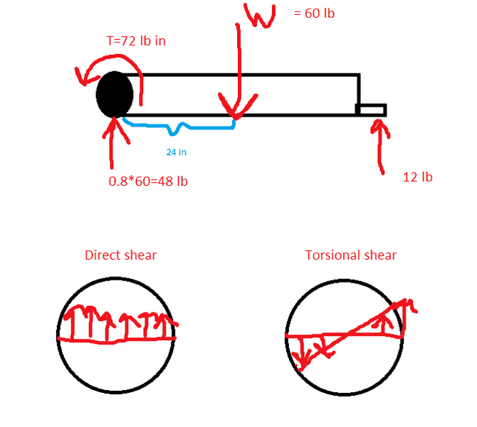

Just to try to see if my logic is correct I put in the given value for d (=.49 in) but I'm not getting the correct answer. I feel like my FBD is incorrect.
The way you have the closing torque drawn would tend to raise the door off the stop, rather than keep the door closed on the stop.

It looks to me like the center of gravity is NOT in the center of the door, and the length to the side with the stop is not given, so I can't do a sum of the moments analysis to get the total torque. Instead I assumed that the given 6 lb ft was the torque acting on the pin. I'm getting nowhere with this problem.

All is not lost.
Imagine there's no torsion spring on the door hinge, and the door is closed.
The weight of the door, 60 lbs, and the c.g. of the door, 24 inches from the hinge, would necessarily produce a torque at the hinge of 60 x (24/12) = 120 ft-lbs, which keeps the door closed. We don't know what force this produces at the door stop, since we don't know how the length of the door from the hinge to the stop.
However, by adding the torsion bar spring to the door hinge, the effort required to open the door should be reduced, if the spring is designed carefully. According to the problem statement, instead of a torque of 120 ft-lbs keeping the door closed against the stop, the spring should reduce this torque to only 6 ft-lbs, which consequently would make it easier to open the door if a force at the stop was applied. It's the torsional stress caused by this reduction in the closing torque which should be used to design the torsion spring.

Just to clarify, are you saying that the torque in the torsion bar is trying to open the door when it's shut? I guess what I'm asking is at what position the torsion bar is neutral? It seems to me that if the torsion bar is to help reduce the torque needed to lift the door once it is shut, then the torque should be acting in the direction that I drew it (I drew my FBD imagining that the door was shut).
So if I understand correctly, the internal torque in the torsion bar, when the door is shut is equal to 114 lb-ft. But it seems to me like we're just ignoring the torque that is produces by the 12 lb force on the door stop. How come we can just ignore it?

I would assume that the torsion bar is in a 'neutral' position when the door is open, for what it's worth. But that's not the condition for which the torsion bar must be designed.
Remember, from your diagram, a clockwise torque keeps the door closed. That's the direction in which the 6 ft-lb net torque must act to keep the door pressed up against the stop.
You don't know that there is a 12 lb. force on the door stop, because you don't know how far the door stop is from the hinge, as you yourself said in a previous post.
Going back to your diagram, the torque caused by the weight of the door, 120 ft-lbs., would be shown acting clockwise. The torsion spring provides a counteracting, counterclockwise torque of 114 ft-lbs acting at the hinge, for a net torque on the door of 6 ft-lbs, which also acts clockwise, thus holding the door shut.

I figured it had to be 12 lb on the stop because the problem says that the torsion bar supports 80 % of the 60 lb. But even if I go with 114 lb-ft, I get the wrong answer. The book says that the diameter should be .49 inches, I get .52 inches
http://www.wolframalpha.com/input/?i=50000=((48*4)/(pi*d^2))+((16*1368)/(pi*d^3))
Sounds like the same answer to me.
Your formula for J is slightly incorrect. For a solid circular cross-section, J = πd4 / 32 in4, where d is the shaft diameter in inches.

Normally I'd agree that it's close enough, but since I didn't round off anything - I feel like my answer should match the book's answer exactly.
J = π* d^4 / 32
and
Tshear= T c / J
Simplifies to 16T/πd^3, no?
Anyway, it's probably close enough. For the length I got 116 inches from
L=(GJ/T)Φ
