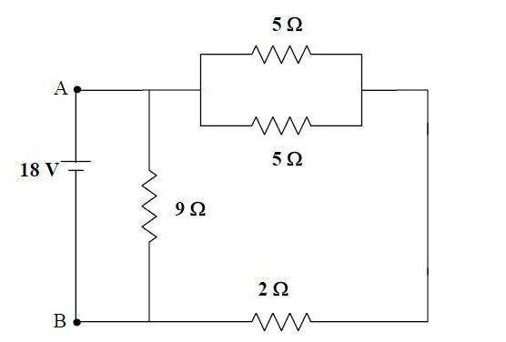

Asking me for total resistance
I added the one in parallel first which is (1/5 + 1/5)=2.5ohm
Then added 9ohm + 2ohm + 2.5ohm = 13.5ohm( which i think it is the total resistance)
but the right answer should be 3ohm.
problem solved
teehee
its 1/9 + 1/4.5 = 4.5/40.5 + 9/40.5 = 13.5/40.5
Therefore 40.5/13.5 = 3ohm
