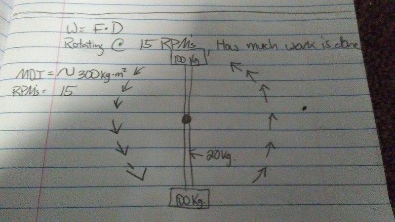

Please see attached sketch. I am trying to determine the total work done by this system. I am not sire where to even start. I know w=fd, but i am not certain how that applies to a rotating object. Please advise.

And remember: work = increase in kinetic energy.
What's the kinetic energy of a rotating object ?
Likes berkeman
Well the moment of inertia is 300kgm2 x 1.57 rad/sec (15 rpms) = 471.6 Nm. Is that rhe KE?
Does it have the right dimension ?

Well you didn't mention torque in your opening post scenario, so you'll have to tell us if there is one and therefore if this example applies.
Pinon1977 said:
work is done by this device
The diagram does not suffice. It just shows two 100 kg masses at the ends of an arm rotating at a constant rate. If that is all there is to it then no work is being done.
There is apparently another force "20kg", but 20kg is a mass not a force, and it is described as a "support", so it is not at all clear what this is or what it is doing.
Likes russ_watters and BvU
My apologies. The torque being exerted in this particular instance would be 120 foot pounds of torque at 15 RPMs. The overall travel diameter is approximately 10 feet with the only real Mass being the 100-kilogram out on each end. However I'm sure the support mechanism is also contributing to some sort of kinetic energy but let's just leave it out of the equation for right now if it's easier. Please advise

Yes i would agree. However i am seeking how much work is done here-not power. Would it be (120ftlbs or 167.2 Nm) x (15rpms x 2pie) = 15750 J? And if it took 60 seconds to do 15 rpms then the power would be 263 watts or .35 HP?
Ok, great. You have a torque and and rpm and a sample problem that uses them to find power...
These pieces of information were not used in your sample problem, right? So why do you think they are relevant here?
It doesn't seem like you understand how work and power are related. Please state your understanding of the relationship so we can tell for sure.
Please pay more attention to your units. An "rpm" has per unit time (minutes) in it. A joule does not. So these units do not match. However, if you are looking for Joules expended in one minute, that's the correct answer.
Again, you expressed it wrong, but the answer is correct for what you probably really meant. Here's how to say it: 15 rpm is 15 revolutions in one minute, or 60 seconds. So 15750 / 60 is 263 joules per second or 263 watts.

Last question. So the total amoubt if work done in a 60 second time period would be 15780 J? Correct?
Yes.

If the "torque being exerted" is the torque required to keep it turning at a constant 15rpm then the input power is indeed about 263W or 15780 Joules per minute.
If there is no load connected to the system 263W is also the same power lost to friction and/or air resistance.
