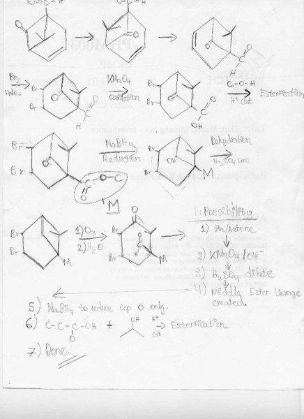

I'm wondering whether it's possible for the following synthesis to occur and how?:
http://harishkukreja.neargeek.net/Synthesis.jpg
The thing is, after bashing my head against it for about 2 hrs - I've really gotten nowhere :cry: . A few of the rxn's we're allowed to use are:

Using dehydration + 2*oxidation + esterification I can change the double bond to the bottom chain. using a similar process also yields the top (though in an isomer form). I'm however badly stuck when dealing with the middle section - further the double reactive sites are also bugging me - and blocking isn't really helping me.

How about cleaving the double bond first, through oxidation. You'll have two carbonyl sites. Note that the left carbonyl created from this is part of an enolate derivative. Using a suitable base, perform the intramolecular condensation reaction, the alpha carbon will react with ring carbon #3 (the other newly formed carbonyl group). This will give you the exact ring structure you need. We'll go on from here.
I'm just going to clarify a bit more...KMn04 oxidative conditions, claisen condensation, and we can go on from there...if you're still around

I figured it out (double checked with an independent source) - and I'll post it as soon I have access to my scanner (~Monday). Turned out to be relatively easy after the 2 tricky initial steps. In total there are 12 steps to the synthesis. I was told there were would be about 10-15 depending on the way one would go about it - so I'm happy with the result. If you can do it in less than 10 I'm interested :cool:

Here it is - just in skeletal format after dashing it off in a few minutes. If you spot any error, chalk it down to being in a rush - unless of course it's a major error, then please do tell. Ignore the term "possibility" - the synthesis continues from the last diagram to "#1" onwards (I just got lazy to draw the rings for each). See the first message for the inital and final diagrams.

You've got a Bredt's rule violation in there. The dehydration won't work.

We were never taught or exposed to Bredt's rule in class (lowly high school kid) - so thank you for pointing that out. What would you suggest I do to rectify the situation?
I dunno. It's a tough question. I came up with an very different route from yours which takes 7 steps, but there are one or two steps that I don't really like myself.
I can't think of an easy solution to your dehydration problem though. Sorry.

@ movies: could you please post your 7 step one - would like to see it (don't personally care if it works or not - just would like to learn something from it). Furthermore, just talked to my teacher, apparently he doesn't care about the violation - didn't even expect anyone to find out that problem.

The problems I see are with the isomers in the Baeyer-Villiger oxidation (it'd probably favor the undesired product) and with saponifying the lactone without saponifying the methyl ester. It might work though...
