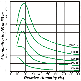

I know of no good reason to expect that wetter days are colder (the converse, however would seem likely), but even if they are, I think that's probably a smaller effect than what dominates any differences that the average human ear can detect easily, and the average human brain can retrieve and compare from memory.
Also, the discussion about sound velocities is somewhat irrelevant (though it is true that temperature, rather than density, plays the dominant role in determining sound velocity). What matters is sound attenuation.
See, for instance: http://www.sengpielaudio.com/calculator-air.htm
At a distance of 30m (100ft), which is not unreasonable for window to road separation, the difference between a day with 10% RH and a day with 90% RH is about 5dB or so, which is nearly a doubling of sound intensity on a damp day (relative to a dry one)! I think that's something a person might notice and remember, though I couldn't say I personally have. Still, this is a little bit removed from the sound of traffic heard during rain. I would imagine the sound of the rainfall to have a more significant effect on one's perception, and would do more to mute the traffic sounds than the humidity does to preserve it.

I guess it comes down to what one means by "traveling better". I would imagine that still refers to sound attenuation rather than speed. In any case, I agree with you about the secondary sounds. We just don't know if wollie is including that in his perception, or if he's just hearing louder vroom-vroom sounds.

I can go with that. But I'd say that the slower sound travels through a material, the less well it travels. I don't know how that affects overall distance traveled though, so I suppose that's where attenuation comes into it.
I've looked at your graph and a number of others and they do vary somewhat. There is one that shows you get about 0.5db of attenuation from 10 to 30 percent humidity, but unlike yours it doesn't show the levels of attenuation to be the same.
Yours: 10% = 1.8db (over 30m)
Other: 10% = 0.8db (over 100m)
Not much I know but would certainly alter the 'end conclusion'. So I'm not sure what to make of the actual numbers, but I do agree regarding there being more attenuation at lower humidity.
http://www.sfu.ca/sonic-studio/handbook/Sound_Propagation.html
Under section 2:
From the diagrams it can be seen that for the middle of the speech frequency range (2 kHz), the absorption is typically .25 dB/100 m for 30% relative humidity and 20°C (68°F). It should be noted, however, it can be as high as 5 dB/100 m at 8 kHz when the temperature is 20°C and the humidity is 10%.
(Emphasis mine)
I'm no expert on this, it just happened to be something I noted when I looked it up. This shows 5dB per 100m for 8kHz, not 6.5dB per 30m as per your diagram.
You can note the graphed values are significantly different too.
Hmm... I don't know why the numbers are different. The trends seem to agree but the difference between 5dB and 2dB could well be the difference between an easily noticeable change in volume and one that's a lot harder to tell, so I reserve judgment on that for now. Your link also says this (which is useful):
