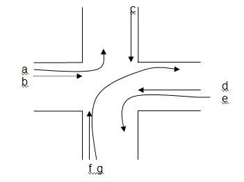

(a) Draw a graph with the vertices corresponding to the traffic flows and the arcs corresponding to flows that can occur at the same time. (Called a compatibility graph)
(b) Show that finding subgraphs of the compatibility graph which are the biggest possible complete graphs, determines the optimum traffic light phasing needed and hence determine that phasing.
The problem is, I don't even understand what the question wants from me. I'm not asking for the solutions for both the question, (in fact there is a third part of the question which I am sure I can answer if someone could help me with question (a) and (b)) instead, I really need help on understanding the question itself and a rough idea on how to solve the problem.
By the way, can anyone tell me what's actually a 'compatibility graph'?
Heh it took me a few seconds to realize what was so odd about your diagram: everyone is on the "wrong" side of the road :biggrin:
Anyway, if I understood the question correctly, this is what they want you to do.
As the question states, just draw 7 vertices a through g. I suppose what they want you to do is: connect every vertex to all the other ones, that can move simultaneously without causing collisions. For example, if the lights for traffic flows e and f a green simultaneously, there is no problem. Allowing d and f to go through at the same time, however, would cause chaos. So you would connect f with e, but not with d. Then the exercise claims that any connected subgraph gives a configuration of traffic flows that can be allowed to move at the same time, without causing problems. Obviously, finding the largest of these, gives an optimum configuration then: as many different lights as possible are green at the same time. But b) asks you to prove that.

I don't think the question has anything to do with a traffic light. a represents a car coming from the west, turning north while b represents a car coming from the east and continuing straight east. By the way, zh3zh3, There is a car turning left from every direction except north so there are 7 cars rather than 8. Was that intentional or an error?
To draw a compatability graph, draw 7 dots labled a, b, c, d, e, f, g . (Add an eighth point, h, if the lack of a car turning from north to east was an error.) Now look at each pair of turns. If two extended paths cross one another, those two turns are not "compatible" (cannot be made at the same time). If two paths do NOT cross then they are compatible. Connect two dots if and only if the two paths are do NOT cross. That is your "compatibility graph".
The "graph" is, of course, the dots connected by lines. The "compatibility" part is just because it shows which paths are compatible (defined in this problem as "can be made at the same time without the cars running into each other).

First of all, I need to apologize for not giving you enough information. My lecturer is a British, so the traffic flows forward on the left hand side.
Second, like what HallsofIvy said, there is a 'h', but that was meant to be the third part of the question:
(c) Suppose an extra lane of traffic, h, is added. This is a right turn next to flow c. Draw the resulting compatibility graph and propose an optimal traffic light phasing.

Ah I see what you mean. What I did was compare two at the same time, not three or more. So, a and b are compatible, a and g are compatible. In the 2nd question, I'm required to find the optimum traffic light phasing.
The first step that I did was, I let a, b, d, and e move at the same time (they won't collide). Because they are all connected to each other and so, this means that all the traffic can occur at the same time. That's the maximum traffic flow I could find.
2nd, I removed a, b, d, and e from the graph. (They are the subgraphs of the compatibilty graph from 1st question) So this leaves me with c, f, and g. I chose f and g so that e could also flow at the same time. ( The priority is for those that have not moved )
Then the third step, c and f or c and a.
Summing it up:
1. a,b,d,e
2. f,g,e
3. c, f (or c, a)
Could anyone suggest any better answer?
