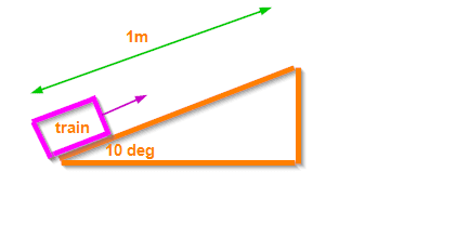

Hi jbriggs444,
I can only assume:
mass of the train - 5000kg = 50000N
speed = 50 km/h -> 13.89 m/sec
inclination of the terrain: 10 degrees (train is climbing up the terrain)
But the previous example for work 10 Joules, was if the train was moving horizontally:
10N * 1m = 10 Nm (Joules)
Not under inclination? Or?
So if the length of the slope is 1meter and it is under 10 degrees of inclination, then the Work would be:
W = 50000N * (1m * cos(10) = 50000N * (1m * 0.9848) = 49 240 Joules
george95 said:
I can only assume:
inclination of the terrain: 10 degrees (train is climbing up the terrain)View attachment 256718
Good. Nicely summarized.
If the 1 kilogram mass were moving horizontally on a sheet of ice, the change in altitude is zero meters. The required force is zero Newtons. It takes no work at all to slide a mass across a sheet of ice.
Think about starting state and ending state. 50000 Newtons of weight is correct. But what is the change in altitude?
You could also worry about whether you are talking about the change in altitude over one meter of track or the change in altitude over one second of duration. You have not yet taken speed into account.
The cosine of 10 degrees is nearly one. Surely the slope is not steep like a vertical wall.

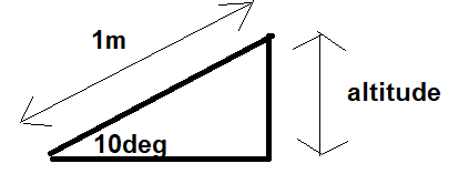

Why sheet of ice? Because we neglected the friction forces?
If we use the length of the ramp to be 1m, then I guess the change should be:
sin(10) = altitude/1m
altitude = sin(10)*1m = 0.1736*1m = 0.18m
Maybe better the change of altitude over one meter of track.
Should we increase or decrease the slope?

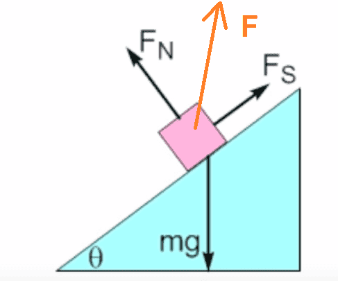

The "F" force from your final formula has two components: "Fn" and "Fs" from this screenshot:
Or am I mistaken?
george95 said:
Thank you for the explanation Jack.
Or am I mistaken?
The one that counts is ##F_S##, i.e the force in the direction of the displacement.
Back a couple of posts you'd calculated using the cosine of 10 degrees. That would correspond to an 80 degree slope -- near vertical. Here you have corrected yourself to the sine of 10 degrees.
You could take the next step and compute how much energy is required to lift a train weighing 50000 N a vertical distance of 0.18 m.
Or am I mistaken?
You show a net force from the tracks that is slanted forward. That will not turn out to be correct. You stipulated that the train's speed is constant. It is not accelerating along the tracks. It is most certainly not accelerating up away from or down into the tracks. Accordingly there can be no net acceleration in any direction.
The net force from the tracks must be directly upward and must be equal and opposite to gravity.

You show a net force from the tracks that is slanted forward. That will not turn out to be correct. You stipulated that the train's speed is constant. It is not accelerating. Accordingly there can be no net forward acceleration.
The "net force" is Fn?
No. ##F_n## would typically denote the "normal" force.
[In physics speak, "normal" means "perpendicular to the surface". It has nothing to do with "typical", "average" or "expected"]

george95 said:
Hi Jack action,
According to this video:
Fs = coefFriction * Fn
coefFriction = tan(10) = 0.176
Fn = mg*cos(10) = 50000kg * 9.81 m/s^2 * 0.9848 ~ 500 000N * 0.9848 ~ 492000N
Fs = 0.176 * 492000N ~ 87 000N
Is this wrong?
According to your video, ##F_S = mg\sin \theta## and that what is important to your train problem. It represents the portion of the gravity that is pulling your train downhill. Therefore, you need to produce an equivalent and opposite force (##F_S##) to counteract it. Multiplying that force with the train velocity, you get the power produced by the train.
