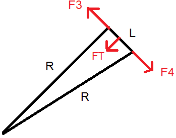

I'm unsure about how to get the radial component of the tension. Anyway here is my understanding of the geometry of the situation:
Is this correct? FT refers to the force due to the tracks. The centripetal force required by the car is
[itex]\frac{MV^2}{R}[/itex]
F3 and F4 are perpendicular to the respective radial vectors. Those radial vectors are separated by an angle (since L<<R, assume the angle, in radians, is L/R). The angle between the two forces is not ∏. You can see this if you draw the cars on either side.
Make F3 and F4 perpendicular to R.
But if the tensions are perpendicular to their radial vectors, how can they have a radial component?
The external forces acting on the car determine the acceleration of the center of mass of the car. After making the force vectors F3 and F4 perpendicular to R at the ends of the car, imagine sliding the vectors to the center of mass. You can now think of the car as a single particle concentrated at the center of mass.
When you add them together, do they sum to 0? If not, what is the direction of the resultant?
