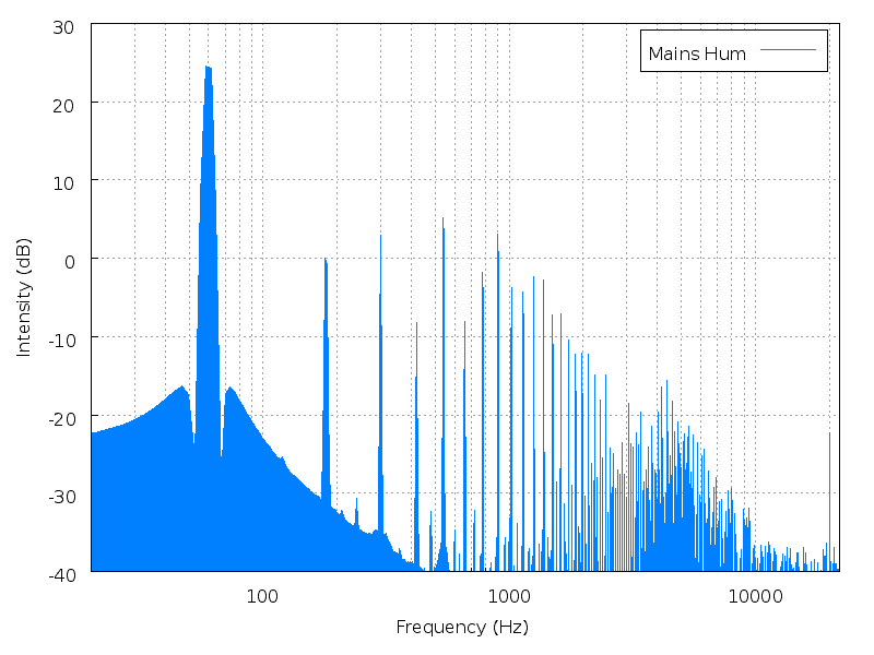

I don't think so. I believe the vibrations he asked about is actually the power line hum. See below from Wikipedia. It is the fundamental, not the first harmonic that we hear.
I find that very surprising, bearing in mind that a transformer is not like a loudspeaker voice coil (i.e. there is no permanent magnet to set up a 'reference' H Field). Where is the direction to a force that will change with the polarity of the AC? I would seriously have expected mostly second harmonic.
It may be that the transformer sound spectrum picture is from a three phase power transformer, which I might have expected to produce sound at the fundamental frequency. The fact that there is a strong peak at the third harmonic seems to confirm my suspicion.
