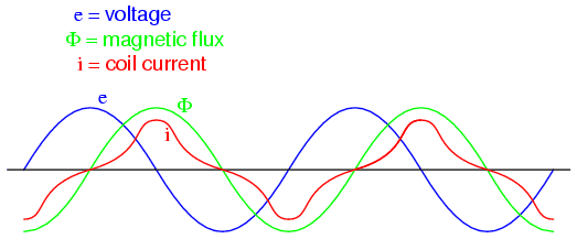

I believe the spikey current waveform is a result of the non-linear B-H curve of the core material. If it is operated in the linear region of the B-H curve, magnetizing current will be sinusoidal. This is possible only in ideal transformers. So, I guess magnetizing current's phasor is drawn only in case of ideal transformer or by approximating the practical waveform to sinusoudal waveform. I'm not sure how it's done since we have not come to that yet in our curriculum..
I see Lychette posted while I was replying to cnh1995's post.
As cnh1995 says, the B-H curve is not linear. As the flux grows, the iron starts to saturate, so that increasing increments of current are needed to make equal increments in flux. The current has to increase to whatever value (and at whatever rate) is needed to make dΦ/dt = E -IR , which makes the current waveform very non-sinusoidal.
This diagram from here shows the effect (though I've seen much spikier current waveforms)
As far as the phasor goes, I guess we work with the fundamental phasor and assume the harmonics just follow along! (Though I suppose the mathematicians will be able to prove it works.)
Likes cnh1995
