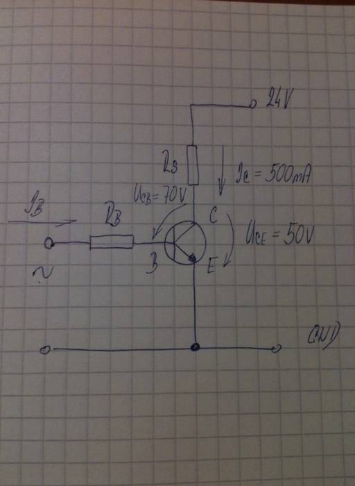

Hello,
I've spend a lot of time at following example of my homework but still unable to find a solution. In fact I have no idea how to solve that, any help would be very appreciate.
Transistor KFY34 has to switch a load of nominal supply voltage 24V and resistance Rs=60Ω.
a)Draw a schematic of electrical circuits.
b)Determinate Ib while the load is switched on.
c)Determinate currents and voltages in the circuit I B = f(t), IC= f(t), UBE = f(t) a U CE = f(t) with the load switched on and off and draw them to a graph.
d)Decide if additional cooling is necessary.
KFY34: NPN, h21E = 35 až 125, UCB0 = 70V, UCER = 50V, ICmax = 500 mA, UCES ≈ 1,5V, PC = 800mW
Ib=Ic/β
Rb=(Uin-Ube)/Ib
The voltages and currents you have drawn are the maximum allowed specifications, not the values that the transistor experiences in this circuit. How could you get 50V or 70V across the transistor, with only a 24V power supply? :biggrin;
Calculate the voltages in the circuit assuming two conditions: 1) the transistor is cut off (Off state), 2) the transistor is in saturation (On state).
Thank you for your answer, 70V with a 24 power supply is a great mistake of mine, of course :)
1)if the transistor is cut off, there would be a full voltage at it, wouldn't it?
2)in saturation mode there's should be voltage drop of 0,6-0,7 due to diode-juction.

Correct. Vce would be 24V in cutoff. What would Ic be?
Somewhere around there, perhaps Vce would be a bit lower than 0.6V. So what does that mean for Ic? And then how can you work back to finding the Ib needed to support that Ic?
If 24V be cutoff, there will be none Ic.
And there would be relative hight Ic while transistor switched on determinated by Rd. But not sure how to calculate it because I don't know beta neither Rd.

Compared to 60 Ohm, you can hopefully neglect the internal resistance of the transistor. You can probably assume it conducts perfectly (just with the internal voltage drop).
So, Ic=400mA. Hm, but what about Ib if assumed we don't know beta?

The current will be also limited by the collector load resistance. Ic=24/60=400mA, so the base current would be Ib=400/35=cca 12mA to ensure the transistor will be open. Is that correct?
That's the idea. But recognize that in practice that exact choice would be sailing too close to the wind. To ensure there is a margin of safety, you'd probably round out to 16 - 20 mA.
