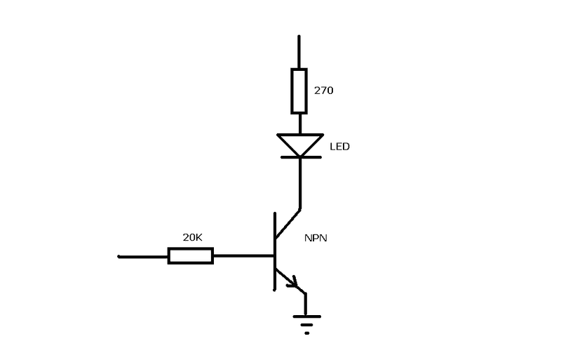

Dear Experts,
Hope all of you are enjoying the holidays so far.
I am newbie dabbling with circuits to make something for myself.
recently, i made a pulsing signal go into a NPN transistor trying to amplify the output required to drive some LEDs using the transistor as a switch. I know this sounds redundant as i could have used the pulsing signal to act as switch. But somehow, i added the transistor to learn to use it as a switch hoping to avoid voltage drop (Vce = 0 at saturation).
I could not reach close to the source voltage Vcc to drive the LEDs which still works but not as brightly as i liked.
Not sure if its due to the input signal not high enough? Am i right to say that the Vce if zero would give me the Vcc , ie. no voltage loss, needed to drive the LEDs?
If so, should i adjust the input current to the base to reduce it further so that Ib(max) can be reached that would give me the Vce = 0 whereby the Collector is 'shorted' to Emitter closing the circuit? Due to the pulses going to the base I could not really tell what was the highest amount of current that pulsed in. What i measured was roughly 600 microamps.
Oh by the way, the pulsing comes from a 555 timer. I experimented with it and found that increasing the resistance at pins 6-7-8 could up the voltage that drives the LEDs.
But i only have 20K ohms.
Thanks for reading my question.
Peace and love to all!
Sincerely
Ramone
You only need about 1.5 to 2 volts to light a LED to full brightness. If it is a white one it may need 3.5 volts. Any more any you risk destroying the LED.
In fact, you may know that you have to limit the current in a LED by adding a series resistor.
So, assuming you are using something like this:
you should be able to do this easily. That 270 ohm resistor is a minimum value for a 5 volt supply. For a 12 volt supply you need about 600 ohms to get 20 mA LED current.
If the 270 ohm resistor is not there, the transistor cannot go into saturation without blowing up the LED, because this would mean the LED had more than its rated voltage across it.
Don't forget that the time the LED is not conducting makes the appear LED dimmer.
Also, LEDs vary a lot in brightness. You can get "super-bright" LEDs for only a small extra cost and these give a huge increase in brightness.
A 555 with only 5 volts on it will only give about 4 volt pulses out across your 20 K resistor. This would mean you have only 200 uA base current. (4v / 20K ).
So you would need a transistor with an actual current gain of 100 to get 20 mA of collector current.
So, if you do only have 5 volts on your 555 you will probably need to make this base resistor smaller. Maybe 6.8 K?
If your 555 has 12 volts on it, you would get about 550 uA of base current which means you need a gain in the transstor of about 36. So your 20 K should be OK.

Hi,
It is perfectly normal for there to be a saturation voltage across the transistor. This can be up to 1 volt for small transistors and up to 4 volts for big power transistors carrying a lot of current.
The resistor you have in series with the LEDs will determine the total current and brightness of the LEDs. You didn't say what value this was, but maybe you could reduce it. Monitor the CURRENT through the LEDs. That is more important than the voltage.
You could also try it with just 5 LEDs or try to get 15 volts or so as your supply. Just the LED voltages add up to 11.4 volts leaving 0.7 volts for the resistor and the transistor's saturation voltage. So, the resistor isn't doing much.
Or, you could put the LEDs in two parallel strings of 3 with a series resistor for each string and then being switched by the one transistor.
There really should be a resistor between the 555 and the base of the transistor. Isn't the 555 getting really hot?

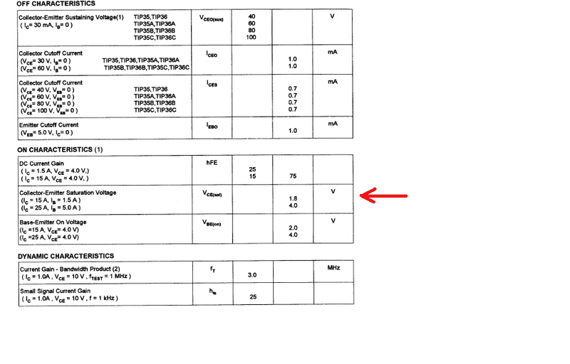

The real problem is that you have too many LEDs in series for the voltage you have available.
With 12 volts available, you need 4 LEDs with 8 volts total across them, a resistor with 3 volts across it and a transistor with 1 volt across it. You calculate the resistor to suit the current you want in the LEDs assuming 3 volts across the resistor.
So, if you want 20 mA in the 4 LEDs, you would do this:
R = 3 volts / 0.02 amps = 150 ohms.
The LEDs will each keep 2 volts across them, almost regardless of the current through them.
You can download data sheets from Internet by looking for them on Google.
They should be free, but some sites want to charge for them.
One good free one is this:
http://www.datasheetpro.com
Here is a section of one data sheet for a NPN transistor, a TIP35
You can see where I have marked an arrow in red that the voltage drop can be quite large if currents are large.
Mosfets are much better at this, but you would only be saving half a volt at low currents.
The base resistor will depend on the base current and the supply voltage for the 555. If the 555 has 12 volts on it, it will give 11 volts out. There will be 0.6 volts across the B-E junction of the transistor, so say there is 10.4 volts across the base resistor, roughly.
The gain of the transistor is about 50 so the base current is the collector current divided by the gain, so maybe 1 mA if you have 50 mA of collector current?
Resistor value = 10.4 volts / 0.001 Amps = about 10000 ohms.
