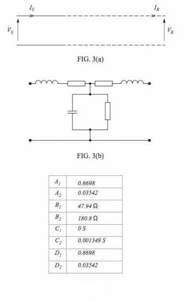

Figure shows a 50 Hz, high-voltage, transmission line. The relationships between the sending and receiving end voltages and currents are given by the complex ABCD equations:
where 'S' stands for sending-end and 'R' stands for receiving-end
(a) Given the parameter values in TABLE C and an open-circuit received voltage measured as 88.9 kV, calculate the values of
and
and hence the power
absorbed from the supply by the transmission line on open circuit.
(b) If the line is modeled by the T-circuit of FIGURE 3(b), see if you can estimate the primary line coefficients R, L, G and C. The line is 50 km long.

With question (a)
If the receiving end is open circuit Ir=0, therefore the equation becomes:
Vs=Vr(A1+jA2)
Vs=88900(0.8698+j0.03542)
Vs= 77325.22+j3148.84Is=Vr(C1+jC2)
Is=88900(0+j0.001349)
Is=j119.93Now the power should be calculated by
P=Real{VsIs*}
P=Real{(77325.22+j3148.84)(j119.93)}
P=377565wI'm hoping I'm on the right track with this?Not sure where to start with (b)

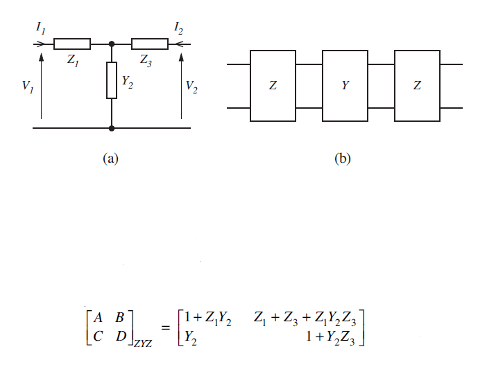

I'm trying to form an ABCD matrix from the lumped components.
You already have the ABCD parameters, both numerically (your table) and in relation to the T network Z1, Z3 and Y1.
For part (b), as I said you already have the relations between the ABCD parameters and T-network components, so just solve for Z1, Z3 and Y3 from those.

Up to here all looks 100% unless you made a math error.
P=Real{VsIs*}
Real power is (1/2)(VsIs* + Vs*Is). Vs is complex since we've defined Vr as having zero phase. P is a real number.
Repeat your computation of P using this formula.

Hi RM
I recalculated the power absorbed to get an answer of 377590W. My textbooks only showed the formula I used above, where * indicates the complex conjugate. I've been trying to find reference to the formula you provided which extended this, but could not find any. Could you possibly point me in the direction of a reference as I'm keen to learn. So I was slightly out with my initial figure.
Thanks
Electest said:
Hi RM
Thanks
You did very well! I apologize for not paying closer attention to your work earlier.
And guess what - our two formulas are identical! Which I found out after some simple math.
So you should have gotten the same answer: P = VsrIsr + VsiIsi.
where r means real part and i means imaginary part.
EDIT: note I changed the expression for P (sign change from last post).

So to get ABCD matrix for the ZYZ circuit i need to multiply the 3 together to get a single matrix?
If that's the case i have the single matrix to be:
0.083......142.84
0.00102.....0.083
but then i can't get that to tally with
1+Z1Y1....Z1+Z2+(Z1Y2Z3)
Y2......1+Y2Z3
Am i going about this in the correct way or am i totally off-course? Also apologies for the formatting, i don't know all of the tags to space correctly.

@Gremlin, you can solve for Z1, Y2 and Z3 in terms of the ABCD parameters.
There are only 4 ABCD parameters:
A1 + jA2,
B1 + jB2,
C1 + jC2,
D1 + jD2.
You are not to separate real and imaginary parts of the four parameters the way you tried to do. You should solve for the three T-equivalent parameters, each of which will (probably) be complex. From that T-network you can then compute the power furnished by the source.
Look some more at posts ## 9 and 11.
EDIT: you can use the T-equivalent network as given in fig. 3(b) of the OP's post 1. The series resistors are R, the parallel resistor is 1/G, and the L and C are obvious.
Thanks rude man,
Just so we don't get our wires crossed here I've already completed part a) and my posts #12 & #13 relate to part b) - don't your posts #9 & #11 relate to part a)?
Ok I've got Z1, Y2 & Z3.

Consider a general ABCD matrix:
[ A B ]
[ C D ]
Now if you have a T network that has that matrix, the elements of the T network will be:
Left series element = (A-1)/C
Shunt element = 1/C
Right series element = (D-1)/C
You can work this out by considering how the ABCD matrix is formed from a T network.
Note that the numerical value your problem gave you for C is 0 + .001349 j
This means that G is zero, which is what I suggested you assume when solving those equations above.
But, now if the shunt element of the T network is 1/C , we just need to solve (because G=0):
1/C = 1/(.001349 j) = 1/(j ω Cs), where Cs (I designate it Cs instead of just C to avoid confusion with the C of the matrix) is the shunt capacitance of the T network.
R/2 will be the real part of (.8698 + .03542 j - 1)/(.001349 j)
and L/2 will be the imaginary part of (.8698 + .03542 j - 1)/(.001349 j) divided by ω.
These values of R, L and Cs are for the whole line; divide by the line length for the final result.
I am also doing this question and am confused by part b. Can this be solved with simultaneous equations ? my conundrum is that I will have 4 terms and want 3 results
Read the section on ABCD parameters here: https://en.wikipedia.org/wiki/Two-port_network
Especially note that for symmetric networks, A=D. For this problem, symmetry means that Z1=Z3, so you only need 2 results.
