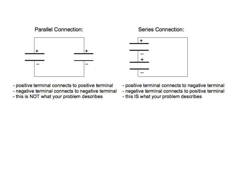

Erm, it is NOT a parallel connection. See the attached file.
It is no sense of series or parallel when only two capacitors are connected. Series and parallel is defined with respect to the other parts of a circuit.
ehild

Not totally sure whether I agree or not, but fine. I'll rephrase what I said: the connections are not as shown on my left diagram. The connections are as shown on my right diagram.
EDIT: and even with ehild's statement above, what the teacher said is still incorrect, which is the point I was trying to get across.

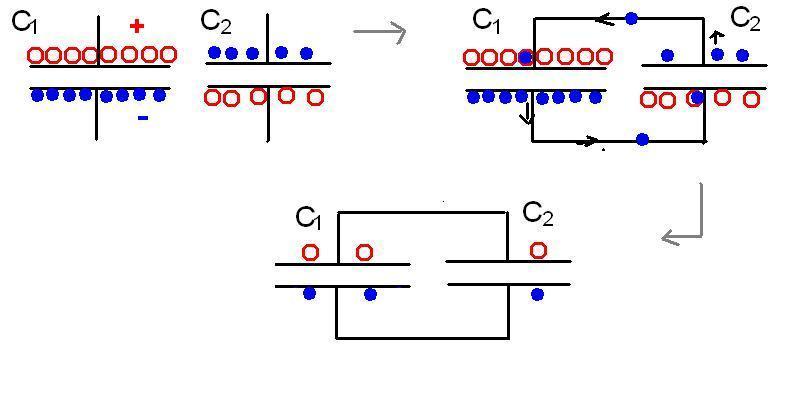

See my picture. At the beginning, the capacitors are charged, C1 with Q1 and C2 with Q2. The blue dots are excess electrons, the red circles are positive ions, missing one electron. Q1=8, Q2=5.
The plates connected, plus to minus. The electrons are attracted by the positive ions, and as they can move freely through the wires, they go to the other side and happily unite with the ions making neutral atoms, until the driving force vanishes. The process is illustrated in the figure on the right. The electrons stop moving when the driving force vanishes, that is the connected plates are at equal potential. At the end, the 5 electrons neutralized 5 ions and 3 positive ions remained on one side altogether and Q1-Q2=3 negative electron on the other side. These charges distribute between the connected plates to result in equal voltage across the capacitors: U=q1/C1=q2/C2 , where q1+q2=3 (the figure below the other two).
@cepheid: What you draw, that one plate is negative, the other positive is only at the instant when the plates are connected. In equilibrium, both connected plates are either positive or negative, according to your first drawing.
ehild
ehild
Understood and accepted! I was actually planning on drawing out something similar to what you just did, but now I don't have to. If I had done so, I would have realized my mistake.
Drawing them side by side like you did also helps illustrate why the voltages on them have to equalize after they are connected. If they aren't, then the cap with the higher voltage will drive charges onto the other one until the two voltages are equal.
