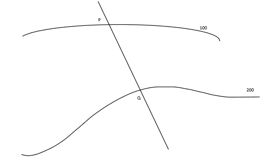

A map shows a straight road crossing two contour levels 100ft., 200ft. at P, Q. The length of PQ is 1.2 inches, and the scale of the map is 4 inches to the mile. What average angle does the road make with the horizontal?
$$\tan(\alpha) = \frac{opposite \ side}{adjacent \ side}$$
The sketch:
First of all find the length of PQ on i.e
$$4 \ inches - 1 \ mile$$
$$1.2 \ inches - x \ mile$$
$$x = \frac{1.2}{4} = 0.3 \ mile = 1584 \ ft$$
Now, I do not understand where shall I draw the horizontal, and the connection between the lengths of the contours, so I'll be grateful if you give me some hints for solving this problem.

Why don't you draw the road incline from the side?
Like this?
No. From the side. So you can see the road going uphill!
You mean from the opposite side? Sorry for my dumbness..
A map is a "Plan". You want an "End Elevation" or "Side Elevation":
I think I understand now.
So the difference between the heights of the road is 100, I have the length of PQ, what I need to do now is to calculate the angle, right?
Note that the distances on a map (you should be able to find out this sort of thing yourself from the Internet) are horizontal distances, not the hypoteneuse of slopes.
Likes nmnna
Okey, sorry for the trouble
