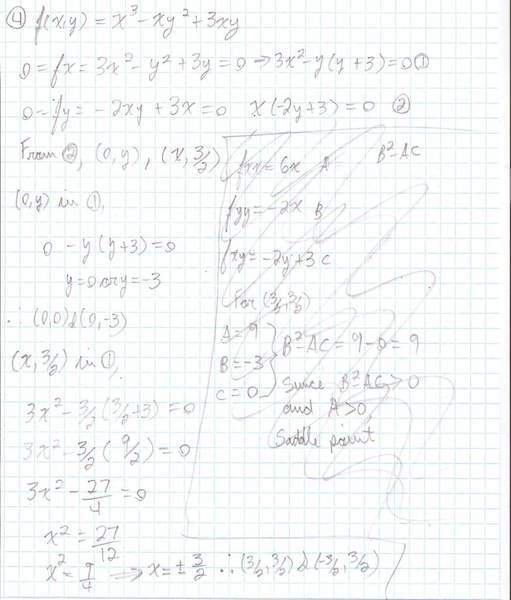

Find all critical points of the function given.(see figure)
Choose and classify anyone critical point.
I found the following critical points,
(0,0), (0,-3), (3/2,3/2) and (-3/2, 3/2)
Wolfram alpha is telling me the critical points are (0,0) and (0,3). (We don't deal with critical points that have complex numbers in them).
I can't find my error.
Can anyone see it?
You flipped a sign when you factored the y terms in equation (1).
