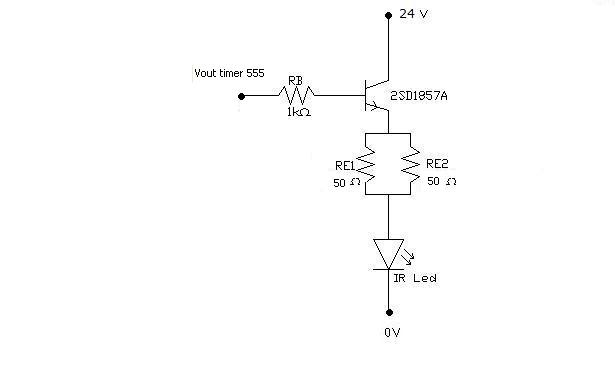

Hi,
Can anyone help me check the circuit and if possible tell me what could be the problems?
At 12V supply,the circuit works fine and I am getting approx 60mA with resistance 100 ohms.
Now I wanted to increase the current by reducing the resistance to 50 ohms.And I got 115mA.
Since there isn't much resistance to reduce,I thought of increasing the current by raising the voltage to 24V.
Strangely the current only increase by 1 to 2 mA and the npn transitor gets hot with some burning smell.
The npn transistor 2SD1857A has a high reverse voltage Vcbo,vceo at 160V.I have no idea why the transistor heat up but no significant increase of current to my LED.
Furthermore,at 12V supply,the vce is about 5V.But as I increase the Vs,the Vce keeps increasing.
So my question is,
1)Why the transistor heated up but there was no increase in current when the supply raised from 12V to 24V.
2)Some of my transistor has very low VCE when current is applied at the base but this transistor has a high VCE.What is the parameter that affects the VCE?I think the VCE suppose to be low when current applied at base.
Thank you.

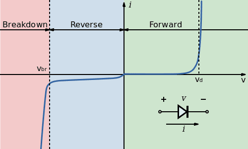

Your transistor is getting hot because it is dissipating a voltage drop of almost 20 volts. This drop has to go somewhere; hence heat. You see, the LED will have a forward voltage at about 2 volts (see http://en.wikipedia.org/wiki/Light-emitting_diode#Colors_and_materials") and the more voltage you apply, only the current increases until its junction fails.
I am sorry but I still don't understand:shy:
Yes,I can understand that diode characteristic curve.
The confusion was why the current didnt increase.If I am not mistaken,the VCE is suppose to goes low once the transistor on.I don't think the transistor is faulty because it was working fine at 12V supply.
Now,let see on the equation,
Vcc=Vce+IR+Vled
If Vce is the same as it was in 12V.
24=5+I(50)+0.9
I=(24-5-0.9)/50
= 362mA
But the experiment showed that the Vce increased to 17.2V.
Hence,
24=17.2+I(50)+0.9
I=(24-17.2-0.9)/50
= 118 mA <-------------------I=117mA when the supply =12V
As you can see from the second calculation;
The current didnt increase but the VCE was the shooting up.If the current didnt increase,why is the heat?
I think something about the transistor is limiting the current.
Could it be hfe has reaches its maximum value? Ic=hfeIb ??
The datasheet of the transistor states:
hfe= min 82 and max 270 (condition Vce=5V and Ic=1A)
The ib= 0.28mA and ic=118mA
hfe=ic/ib=421 gain (way above the parameter stated)
I don't really understand how the ic can shoot until 118mA in the first place if gain is max at 270.
Power in the transistor is voltage across it times the current. So, if the current stayed the same and the voltage went up, then the power increased. So, it got hot.
The voltage at the emitter cannot exceed the voltage from the 555. In fact it must be less than the 555 voltage by the base emitter voltage plus whatever voltage is across the series base resistor.
So, this sets a limit on the emitter current and it doesn't matter what you do with the collector voltage (except reduce it), the emitter current will not change, so the collector current will not change.
When you measure these currents are you allowing for the duty cycle of the 555? A normal meter will give you an average, but the "on" current will be higher.
Hi Mike,
So the limitation is actually on the timer output?
Vout timer = Vb+Vbe+IeRe+Vled
Ie=(Vout-Vb-Vbe-Vled)/Re
So if this Ie cannot increase,Ic will not increase too.
So if I raised Vcc to 24V,the extra voltage will dropped at the CE junction of the transistor and hence the heat by P=VI.
Is it something like this?

Another way to think about what's going on: Assume the transistor is 100% on. As others have stated, the voltage Base to Ground is limited by the 555 to be < 5V. Assume it's 5 V. Take away 1.2 to 2 Volts for the LED drop. Call it 2 volts and ignore Vbe for a moment (about .6 volts). That means that 3 volts are dropping across the 25ohm resistor. V=IR, so the current is limited to 120ma, just what you are seeing.
Doesn't matter what Vs is. Except that at 24 Volts, you have to then have 19 volts Vce. 19V X 120 ma = 2.28Watts dissapated by the transistor. That's a lot, therefore heat buildup if no heatsink.
You can always put a series resistor from +24 volts to the collector, so that the IR voltage drop is ~15 volts (R = 15/0.12 = 125 ohms, I2R = 1.8 watts), and reducing the transistor power loss correspondingly.
