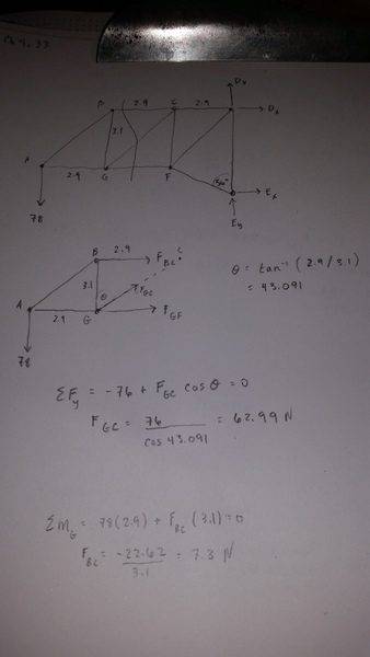

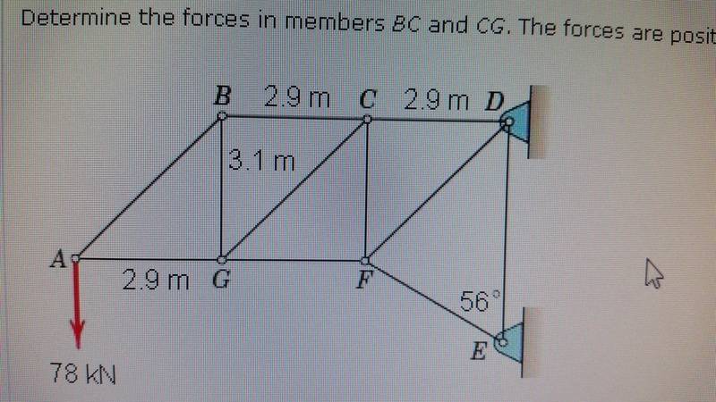

Determine the forces in members BC and CG. The forces are positive if in tension, negative if in compression.[/B]
ΣF=0
ΣM=0
I don't know where I am going wrong, My equations include the applied force, since there is only one.
solved. I had some signs wrong and copied down 76 insted of 78.
