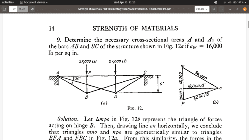

i recently started reading Strength of Material by Timoshenko and in the first chapter encountered a problem in one of the solved examples (attached screenshot)
The problem is of a truss with point load,
i dont understand the second figure(b) particularly how it was calculated, i tried using method of joints, but i am getting different results.
xyz
xyz

@berkeman thanks for replying,
i don't know where to begin, i skipped the question for now
i only have used method of joints where i did:
assumed equilibrium conditions and hence did,
1) sum of all horizontal forces = 0
2) sum of all vertical forces = 0
3) all moment about a point = 0 and calculated the force values
problem is i start the problem with another value
for example:
i take initial force of 27000 lb to calculate value of AB
whereas, the author starts with 18000 lb and hence, i get different result
my values for AB : 27000 lb - initial force ; and get 54000 lb - as tension force on AB
author's values for AB : 18000 lb - initial force ; and gets 36000 lb - as tension force for AB
i think i am missing some concept that has to be applied before appling the method of joint or some other method. i just don't know what it is
I got the answer, thanks to someone named NRG99
solution i found: using the triangle law of forces as suggested by NRP99
Now that i think on it, i was too concerned about why it was that 18000 and 9000 were written seperately and if they had any physics significance turns out it was just a mathematical by-product of solving the problem and doesn't represent anything
