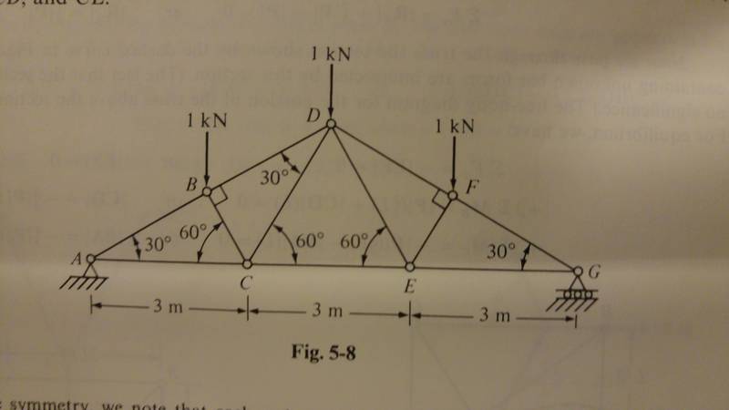

How to find forces in bars BD CD and CE?
Static[/B]
Bd: -2.5 KN
Cd: 0.866 KN
Ce: 1.73 KN
The forces in truss bars BD, CD, and CE can be calculated using the method of joints or the method of sections. The method of joints involves analyzing each individual joint in the truss to determine the forces in the bars connected to it. The method of sections involves cutting the truss into sections and analyzing the forces in the bars within that section. Both methods use the principles of equilibrium to determine the forces in each bar.
