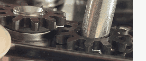

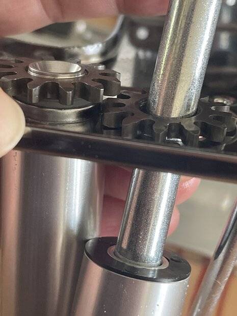

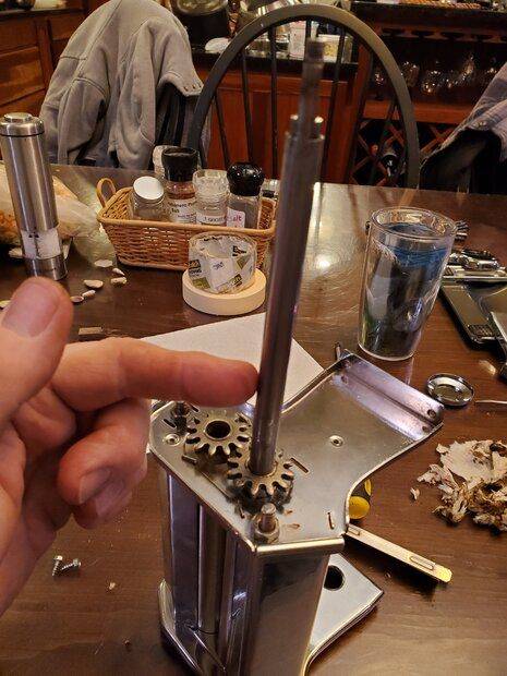

The eccentric shaft should NOT be pushed or hammered through the roller, it should be pulled. The inner shaft will reduce diameter when stretched, the roller will increase diameter when axially compressed.
To pull the shaft, place a stack of flat washers on the eccentric shaft, pressing on the gear hub. Lubricate the thread, then gradually tighten the crank retaining nut, given time, the shaft may begin to creep out, tighten the nut again each time it creeps forward, insert more washers as needed.
The roller and possibly also the eccentric may be stainless steel. Since chlorine salt and water are present the steel should be grade 316. Stainless steel is known to gall and seize if insufficiently lubricated.

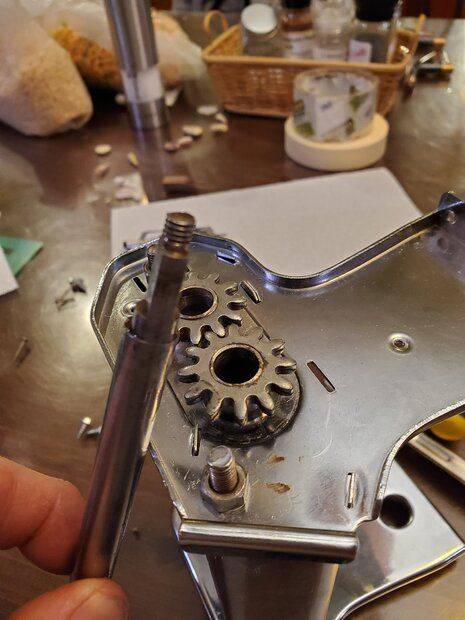

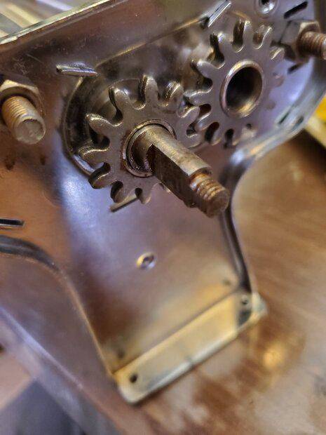

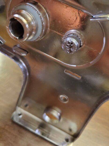

Alrighty then... I did it. Fixed mine. Works great now. Was very hard to turn a couple hours ago. I gently tapped out the center 'spindle' from the roller that the adjustment knob fit on. (I was lazy and use a Phillips screwdriver that was near me, thus the dents in the end of the spindle). No pulling required. I didn't even have to take the whole thing apart, just took the ends off. It was pretty gummed up in there as anticipated. (No before pics, sorry.) I wire brushed and buffed the spindle, and tapped it back in after a light coat of mineral oil. I also ran a rod with 600 grit sandpaper through the roller to try to clean that out too. My wife is very happy.
How did you take the adjustment knob off to be able to unscrew the face plate that covers the rollers?
