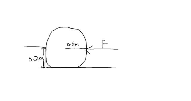

Find the smallest horizontal force required to push the barrel over the step.
n/a
By the principle of moments,
F x 0.2 = 1500 x 0.5 .
Thus, F = 3750N.
I think that there's a smaller force, right??

What's the height of the force F? Where's your pivot?
the height is 0.2 + 0.5 = 0.7m.
The pivot , i suppose is the edge of the step ??
Your diagram shows the force level with the center of the barrel. I guess that's wrong? And the height of the step is labeled as 0.2, but it's drawn as being at the height of the force.
What's the height of the step? Where is the force applied? At h = .5? or .7?
Right. So what's the moment arm (distance) for computing the torque due to F?
What's the height of the step? Where is the force applied? At h = .5? or .7?Right. So what's the moment arm (distance) for computing the torque due to F?
My apologies. the height of the step is 0.2m . And 0.5 represents the radius of the circle.
The force is applied at the height of 0.7m

Excellent. So what's the torque due to that force about the pivot? And what's the torque due to the weight of the barrel?
It should be, F x D = 1500N x 0.7m = 1050Nm
What's the value of D? I assume the barrel weighs 1500 N? How far is the center of the barrel from the edge of the step?
Distance of Barrel from the centre to the edge of the step
= 0.5m
so is it F x D = 1500N x 0.5m
= 750Nm ??
the weight (1500N) is not perpendicular to the distance so it's not 1500N x 0.5m.
you need to use some trigo here, i think (unless there's a shortcut method).

I think i got it.
F x D , = 1500N x ( 0.5m - 0.2m )
= 450Nm

No. That's the radius of the barrel. (Use a bit of trig/geometry.)
= 750Nm ??
Again, D is the distance between the line of the applied force F and the pivot. So what is D?

0.5m - 0.2m = 0.3m

What's the height of F? What's the height of the step? The vertical distance between them is D.
Okay, so the torque is 1500 x 0.3 = 450N ?

OH! actually i just realized we don't need to do all that.
F x 0.3 = 1500 x 0.4
That's it (the sides of the triangle I've drawn is found using pythagoras' theorem). Sorry for complicating the matter :tongue:

where does 0.4 comes from ??
  • #32
why do all these? from the centre of the barrel to the edge, its still the radius that is concerned , which is 0.5. is there a need to use pythagoras theorem ??
  • #33
you need to find the perpendicular distance from either of the forces to the fulcrum (i.e. the edge). Look at my diagram again the 0.4 is one of the sides of the triangle I've found using pythagoras' theorem. This is the simplest method.
