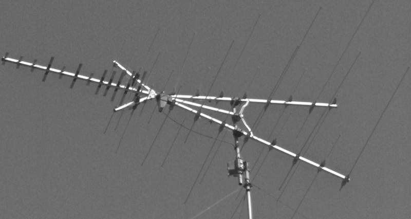

Hi guys,
I have a really strange problem with my TV reception. I got a converter box and had no problems for several days after the DTV conversion. I received all of the channels perfectly. I understand two stations (KVIE 6.1 & KXTV 10.1) converted from UHF broadcasts to VHF (?) several days after the conversion. Suddenly those two stations disappeared while I could still receive all of the rest from tower “S” with no problem! (ref: http://www.fcc.gov/mb/engineering/maps/ , my zip 95746).
I’ve attached a photo of my antenna (If I did it right). Could the antenna be the problem? It looks a little different than most antennas; does anyone know why?
Thanks
The TV antenna looks pretty impressive.
If the TV stations changed frequency, you would have to rescan with the converter box. Have you done that?
According to that FCC site, the two signals should be quite strong in your area.

Your antenna looks to have both VHF and UHF elements. Are you sure the new broadcasts are coming from the same direction?
Hi VL6kro, thank you for verifying the antenna is a big one. I know that we need a strong one in our area. And thank you for the advice. We did rescan way back when they converted and did not get the stations...however, we just rescanned and lo-and-behold guess what now shows up! st.6 and 10. :blushing:
shesh...guess I should of kept trying...thanks again for the help. :redface:

Hi Berkeman, thank you for confirming that the antenna is both UHF and VHF! That was my main concern...that and I wondered if we needed a stronger antenna.
However, we tried rescanning and now we have both ch.6 and 10! :blushing: Guess I should of kept trying the rescan but I wondered about the antenna and the frequencies...
thank you again for your help and for verifying we have both VHF/UHF on the current antenna! I will now know if we loose a station to just rescan!
