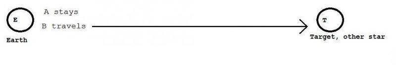

Dear PF Forum,
Sorry if I ask (again) about twin paradox, after so many question about this topic here.
Supposed T is a star 100 ly from earth.
If B travels to T from earth
A. Is the symmetry broken?
B. If B watches A's clock at Earth and A watches B's clock at T, do they see the other clock late by 100 years, no matter how fast B travels?

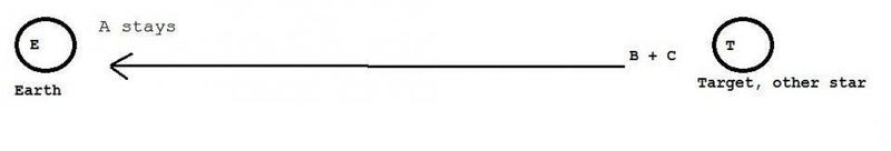

Now B travels back to A, and now B brings a companion C, to travel with him, sitting beside B
C. Is the symmetry broken for A and B?
D. If the symmetry is broken for A and B, what about for B and C?
1. Does B sees C age faster along the journey?
2. Does B sees C gesture/act in fast motion?
3. Does C sees B gesture/act in slow motion?
Which symmetry?
You can use the equations to calculate it. Or have a look at one of the many examples in other threads and other websites.

Thanks Mfb for the answer.
What I meant about the symmetry, is the Twin Paradox Symmetry.
If B travels and A stays, but B doesn't come back. The clock symmetry is maintained, right?
But if B changing his inertial frame of reference, the symmetry is broken. Is that so?
Rather than answer this question as you ask it (since it's vague), let me just describe what A and B would see as they watch each other's clocks. We assume that, when B departs from Earth, A's and B's clocks are synchronized and both read zero. When B arrives at T, he emits a light signal containing his current clock reading and the current clock reading on T. Let's suppose, for definiteness, that B travels at 87% of the speed of light relative to Earth and T, so the time dilation factor is 2. Then, when B arrives at T, his clock will read about 57.75 years, and clocks on T when he arrives will read about 115.5 years. When B's light signal, emitted when he arrives at T, reaches A on Earth, A's clock will read about 215.5 years. From then on, since B is at rest at T, the signals A receives will show clock readings for T 100 years behind A's clock reading when the signals are received, and clock readings for B about 157.75 years behind A's.
Now let's look at what B sees. When he arrives at T, he sees a light signal that was emitted at A at just the right time to arrive at T at the same instant he does. When B receives this signal, his clock reads 57.75 years, and the clock reading on A's clock that is contained in the signal is about 15.5 years. And clocks on T at this instant (assuming they were previously synchronized with Earth's using the Einstein clock synchronization convention) read about 115.5 years. From then on, since B is at rest at T, the signals B receives from A will show clock readings 100 years behind T's clock readings when the signals are received, and about 42.25 years behind B's clock readings when the signals are received.
How is C's clock set to start out? Is it synchronized with clocks on T, or with B's clock? I'll assume C's clock is synchronized with T's clocks to start out. And I'll assume that B and C leave T for Earth when T's clocks read 1000 years, and they travel at 87% of the speed of light, just as B did when traveling from Earth to T.
Then, when B and C start out, they emit a light signal to Earth showing both of their clock readings. Those will be 1000 years (for C) and 942.25 years (for B). When A receives this signal, his clock will read 1100 years.
When B and C arrive on Earth and meet A, B's clock will read 1000 years, C's clock will read 1057.75 years, and A's clock will read 1115.5 years.
B: 1000.00 years
C: 1057.75 years
A: 1115.50 years
But, why A's clock runs faster than C's clock. From C point of view, it's A who travels, right?
Is it the rocket acceleration? But, they say acceleration has small effect on time dilation. Only changing inertial frame of refence does.
When B and C arrive on Earth and meet A, B's clock will read...
"Arrive on Earth" suggests that B is changing it's frame of reference, right?
"Meet A" suggests that either (B and C) or (A) are moving, but then again motion is relative, right?
Whether or not that's true depends on which frame you use, the frame in which A, Earth, and T are always at rest, or the frame in which B and C are at rest while they are moving (but not before they start or after they arrive). Changing frames means changing simultaneity conventions; in the frame in which A, Earth, and T are at rest, B and C start out from T "at the same time" as A's clock reads 1000 years. But in the frame in which B and C are at rest while they are moving, B and C start out from T "at the same time" as A's clock reads 1086.6 years, so in this frame, A's clock only advances by 28.87 years during the journey, half of the 57.75 years that B's and C's clocks advance. This is just standard relativity of simultaneity.
No, it says that B changes his state of motion. Changing state of motion is not the same as "changing frame of reference". Any frame of reference can be used to describe B's entire motion, before and after he arrives on Earth.
No, it says that A's, B's, and C's worldlines all coincide. There is no assumption about who is "moving" and who is not.
