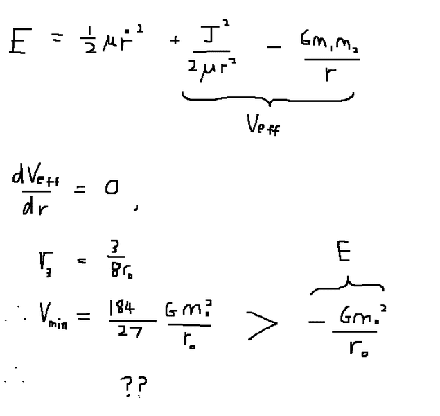

What puzzles me is part (c), I got Vmin > Etot which suggests that the orbit is no longer bounded..

The question gives no information about whether the explosion affects angular momentum/energy or not...I'm assuming angular momentum and energy stays constant.

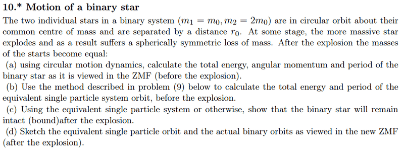

In part (c) of the question I'm asked to show that the binary star remains bound...
Think: What does it mean that the exploding star "suffers a spherically symmetric loss of mass"? Does its momentum change in the explosion?

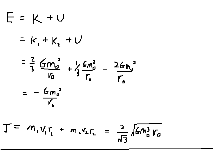

Just after the explosion, you have the half star and a spherical shell around it. The CM of the shell coincides with the centre of the star, and travels with the initial velocity of the star, while the shell itself can expand with a high speed. You are left with two stars at distance r0 from each other, having the same velocities v1 and v2 as before the explosion. The new CM of the two-star system travels in opposite direction as the shell, but that does not influence if the starts stay bounded to each other or not.
The energy of this binary star system is 1/2 m0(v12+v22)-Gm02/r0. Substitute v1 and v2 from the solution of the original system.

Yes, but the problem is the total energy comes out as less than the effective potential, implying a non-bound state..
I do not know what you call effective potential. If you think that the angular momentum of the new two-star system with respect to the original CM is the same as the initial angular momentum, you need to prove it.

I see now that you added the angular term of KE to the potential energy, and called the sum "effective potential". Stay with the definition of KE as the sum of 1/2 mv2 of both stars, using their velocities with respect to the new centre of mass.

I used the wrong angular momentum; i used the angular momentum before the collision and put it in the new energy equation..
