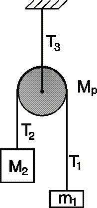

A pulley with mass Mp and a radius Rp is attached to the ceiling, in a gravity field of 9.81 m/s2 and rotates with no friction about its pivot. Mass M2 is larger than mass m1. The quantities Tn and gare magnitudes.
(Select T-True, F-False, G-Greater than, L-Less than, E-Equal to. For example, if the first is T, the second L and the rest E, enter TLEEEE).
A) T2 is ... T1.
B) m1g is ... T1.
C) m1g + M2g + Mpg is ... T3.
D) The center of mass of Mp+M1+M2 accelerates.
E) T1 + T2 is ... T3.
F) The magnitude of the acceleration of M2 is ... that of m1.
A) T2 is greater than T1 since the pulley needs a bigger torque to rotate in that direction
B) m1g is less than T1. T1 = m1g + ma hence T1 is greater
C) m1g + m2g + mpg is equal to T3 because it holds up the whole system
D) I believe it is true since the whole system is accelerating but i am not sure
E) T1 +T2 is less than T3 because T3 holds up the whole system while T1 and T2 only take into account the masses and accelerations
F) The magnitude of the acceleration of M2 is equal that of m1 because the are all accelerating at same magnitude just different directions
I tried many other combinations but i can't seem to get it right..
Help would be appreciated :)
Is the acceleration of the centre of mass zero?
How would this affect the answer to the previous question?
The answer is correct, but I would here rather just consider the free body diagram of the pulley.
But how does the acceleration of the mass affect T3? T3 just holds up the whole system so isn't T3 just related to the mass of the system and not the acceleration?
T3 and the total gravitational force are the only external forces acting on the system. What is the acceleration of the CoM of the whole system?
It is accelerating in the counterclockwise direction making m2 go down and m1 go up so the negative direction..?
So based on this, what can you say about (m1+m2+mp)g - T3?
Edit: It also helps to think about special cases. What should happen when m1 = mp = 0?
Based on (m1+m2+mp)g - T3, T3 would be equal to (m1+m2+mp)g. but i don't understand what you mean by m1=mp=0 :S
As I said, you are implicitly making the assumption that the center of mass does not accelerate. This is not true in general. If m2 is not equal to m1 and the system accelerates, then the center of mass accelerates. You must take this into account in your force equation.
Regarding puttin masses to zero: It often helps intuition to think of what would happen in extreme cases, such as when some masses are very small in comparison, which essentially corresponds to them being zero.
C) m1g + m2g + mpg is greater than T3
D) true since the whole system is accelerating evern the pulley
This showed as incorrect... Can you spot where i am wrong?
.. and because m1 is accelerating upwards.
Right answer, wrong reasoning.
The question is in regard to the mass centre of the system. Each component contributes to that in respect of the acceleration of its own mass centre. Is the pulley's mass centre accelerating?
The fact that the mass centres of certain component are accelerating does not imply that the mass centre of the system is accelerating. The accelerations of the components might cancel each other. You need to explain why they do not.
Consider the net vertical force on the pulley, and the vertical acceleration of the pulley.
Yes, but the reason you give is just restating the answer. Why are the magnitudes the same?
Thank you for clarifying the explanations! From what you have said it seems that it is on E) that i am wrong. when i consider the net force and acceleratin on the pulley, the vertical accelerations cancel out since the both masses are accelerating at the same magnitude but in opposite directions. for the forces we have two tensions acting down and one tension acting up on the pulley. so wouldn't that make T3 greater since it has to account for the 2 tensions acting down?
from the last combination i posted, is there anywhere else where i am wrong?
No - I somehow missed out my comment on C:
If the system were static it would certainly be true that m1g + m2g + mpg is equal to T3, but the system is moving. Consider the system below T3 as a unit. What is the net force on this? Is its mass centre accelerating?
MissBisson said:
on E) ... when i consider the net force and acceleratin on the pulley, the vertical accelerations cancel out
No, again it's just the explanation that was unconvincing. When you consider the individual components of an assembly you need to focus on each in turn. The pulley doesn't 'know' anything about the suspended masses and hence nothing about their accelerations. Its only connections with the outside world are gravity and the tensions.
Ohh alright i understand what you mean! however since the pulley is not moving it would be considered a system at equilibrium for that specific case, with a tension force on both sides of the pulley acting down and one acting up. so wouldn't that make T3 = T1+T2?
You're forgetting the force of gravity on the pulley.
ah right that makes sense so T3 is greater than T1+T2
Thank you for clarifying that :) your help is very much appreciated!
i went to talk to my prof and there was a glitch in the system, my last post of answers was correct, the system wasnt reading the lower case letters.
so the final answer is
D) true
Thanks again for everything :)
