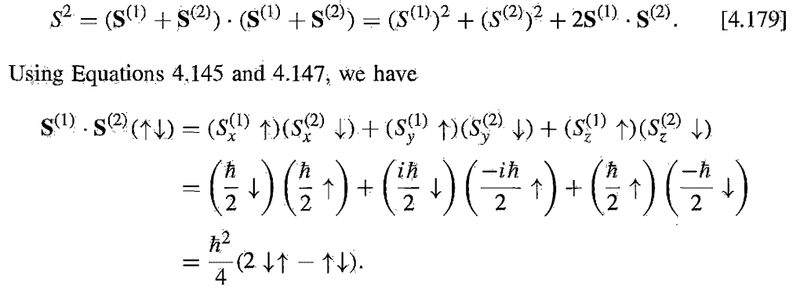

I only studied two spin half particles from the book Introduction to Quantum Mechanics by David J. Griffiths. I do not know if this enough For example see the attached picture.
I know he uses that shorthand notation, but that was something I didn't like. I learned QM from that book but I took some time to find out about the tensor product of hilbert spaces ##\otimes##. As, otherwise, I couldn't figure out what was going on with those composite operations.
If you've got that book, then look at the triplet and singlet states on page 185 (2nd edition). That should give a big clue of how ##S^2## works.
Also, Griffiths does some of the calculations for ##S^2## on page 186: note the decomposition of ##S^2## as I indicated above:
