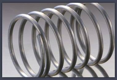

Not really something I am working on at all, but a while ago I had heard that engineers for some of the race teams, mainly NASCAR have developed and put into use and compression spring that has a uniform force of the entire distance of deformation. To put it better, you have a suspension spring in a car, at the exact start of travel it is at 600lbs, and remains at 600lbs until coilbind. Has anyone ever heard of this? Is this even possible? I have been rolling this around in a my head for a long while, and no matter how i come up with it, I do not see how this could be possilbe.
Any insight or opinions?

If you're asking how it can be done in general (I don't know how this specific spring was made since I'm not looking at the design), some of the factors influencing the stiffness of a coil spring are the diameter of the spring, the diameter of the coil, the number of coils and the material being used. If these are all constant over the length of the spring, you'll end up with a linear force versus displacement characteristic. But if you vary the parameters by, say specifying the shape of the spring as conical rather than cylindrical or if you vary the pitch of the coil (number of coils per unit length) you can design the spring so that it approximates a constant force over a given displacement range.

here is the main problem with that theory... if you make it conical, or vary the pitch or even vary wire thickness, you are still going to reach a point where somewhere in the travel the force applied to continue the compression will have to increase.

Of course. Even with an F=kx spring, it will bottom out at some point. Every spring assembly has a limited range of useful travel. It's likely that a constant force spring will have additional limitations on the range of travel where the force is approximately linear.
