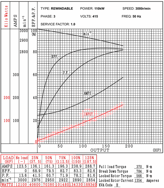

The wheel does get pretty hot but it's all steel so that's not a big problem. I came across this motor curve.:
It's not for my motor (I still don't have the exact specs of the motor) but if I understand correctly it shows that as motor load increases the watt input increases. That's what I was asking in the OP. Right now the motor is using 3 kW input and doing 3 kW of work, minus system losses. If I require say 5 kW of work from the motor the input will change to 5 kW to compensate. Do I have that right?
