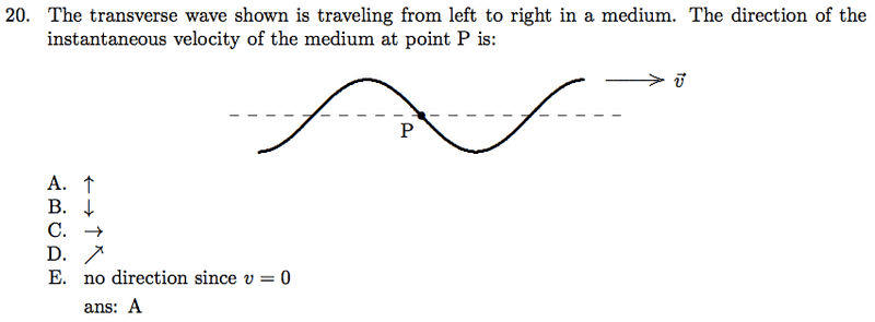

Q. 20 and 21: This seems also pretty simply but I may be missing something here. To find instantaneous velocity is to take the derivative (find slope of tangent) at a point. Looking at the question like this, my answer for 20 would be E and 21 would be D. Am I missing something fundamental here?

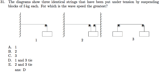

Q. 31: This question also didn't make complete sense to me. Looking at 3, the tension appears to be the greatest since there's one string and 2 masses for which it must be keep up. 2 looks like the lowest and 1 is intermediate, since FT ~ v2. Once again, am I missing something big here?

For Q20 and Q21, try to imagine what happens to point P as the wave moves to the right. The waves are traverse in both cases, so a point "on" the wave cannot by definition have a longitudinal velocity component, just a traverse component, hence it can only go up or down.

q. 31
If you haven't done so already, draw free body diagrams for all the cases depicted. You can then figure out the tensions in all of them. Notice that case 1 and 3 are equivalent because the forces on both ends of the rope are the same (in the first case, the wall must exert a force equal in magnitude to that of the weight of the block, otherwise it wouldn't be in equilibrium anymore).
