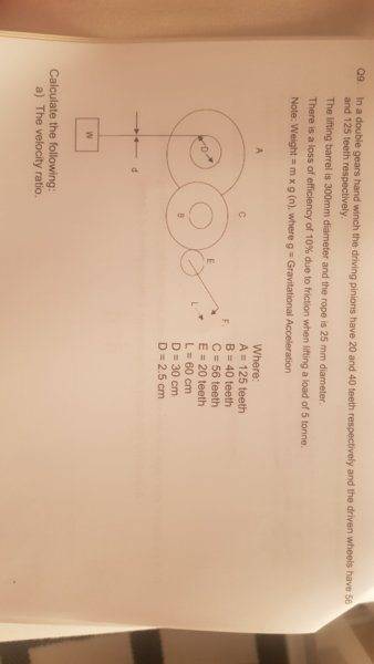

Thanks for ur reply. So how come in book it inverts it? I dnt quite understand

I can't read what the book actually says - it's too blurry with no contrast. But I think, if you read the book carefully (as I cannot) then you should find the distance moved by the Input and output teeth is the same but the input torque is Input Forcein times its radius and the output torque is Forceout times its radius. If you are still confused then, rather than trying to make sense of the book, work it out independently. Unless the book is actually wrong (never impossible to find a typo) your final result will agree with it.
Apply the 'does to make sense?' test against your experience of gears.
PS Read my earlier post again and digest the message; it shows how one could get things back to front.
