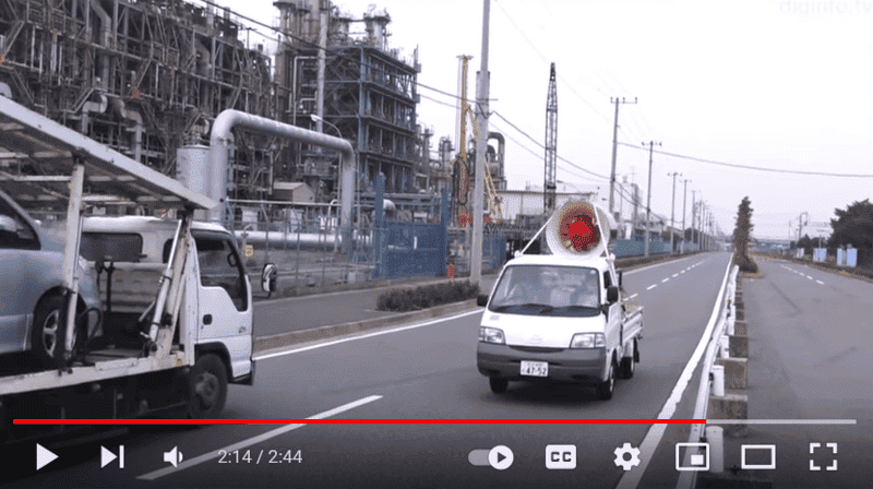

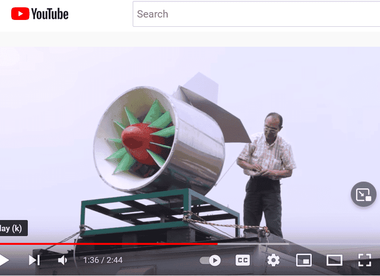

I have recently find this video and just curious about the working principle behind this concentrated windmill. Apparently it seems that the basic principle is Venturi effect but the shape of the entry point is more suitable for Coanda effect with its curved surface at the entry. And it's also highly possible that this is a combination of both. Want to know others opinion regarding this matter especially from those who has ever tried to build something similar.
I don't see that it has anything to do with the coanda effect. It kind of uses the Venturi Effect, but it's not exactly or all.
There's a lot of sources online for how wind concentrators work.
The entry point has curved surface. Doesn't that related to Coanda effect?
Not if the surface is pointed into the airflow.
Focus less on the names of phenomena and more on physical principles. I agree this has nothing to do with Coanda and seemingly nothing to do directly with Venturi, so the real question here is what principles were actually intended to be described when using those two names.

I have to admit I'm curious what the goal here is. It's almost never worth the effort (actually, it's never worth the effort in my experience, but I am always hesitant to make absolute statements) to duct or concentrate wind on a wind turbine, because for the same amount of extra material and expense, you could just make the rotor larger and gain far more energy than you will ever get from a concentrator.
Likes russ_watters
@ cjl, kindly look at this video and see how the RPM dramatically increased after introduction of a venturi. And here is one more example and see by yourself the difference between having a venturi and not having it. Just search youtube with "venturi turbine" and you can see tons of examples.
So a couple of comments there.
That first one is really basically irrelevant to any practical wind turbine design. Sure, it's great as a basic science demo for learning, but if you want to talk about maximizing efficiency and output, you really have to start with a design using lifting blades rather than cups (since you sacrifice so much with the cups that it's basically never worth it except at very small scale if you just want a simple design).
As for that second video, I'm amused by the claim that palm springs is the wind turbine capital of the US. In reality, northwest Texas and Iowa are the leaders in US wind generation, and it isn't close (I worked in wind turbine design for a number of years). Everything about that video just screams that they have no idea about modern wind turbine design though. Maximizing efficiency and output is all about going big, so contrary to their claim at 42s in that video that a standard turbine spins 800rpm, a typical onshore wind turbine with 50-75m blades spins more like 11-13 RPM. Generally the more powerful they are, the slower they go too, since you want to keep a fairly constant tip speed (usually ~75-90m/s) and more power means a larger turbine.
Next, I'm confused why they have what look like repurposed fans or blowers as their turbines. The dense mesh around the blades is going to kill their efficiency, since it's obstructing a lot of flow and it's also going to cause a ton of turbulence. There's a reason why all actual professional wind turbine designs are completely out in the open air. Their blade design is awful too. They also don't show any power measurements, and I get the feeling they aren't even applying a load, but rather they're just letting them spin freely. Electric generators have more resistance when they're actually, well, generating, so freewheeling tests tell you very little. That having been said, I'm sure their concentrator does better than their other one, but they're both awful.
Also, again, I didn't say it doesn't increase the output to add a concentrator or duct, I said it's generally not worth the expense, materials, cost, and structure, since you'll get a greater increase in output by just making the rotor bigger. For the same amount of materials and cost as the concentrator, you could just make the blades on the other one twice as long, and you get far more energy that way.
