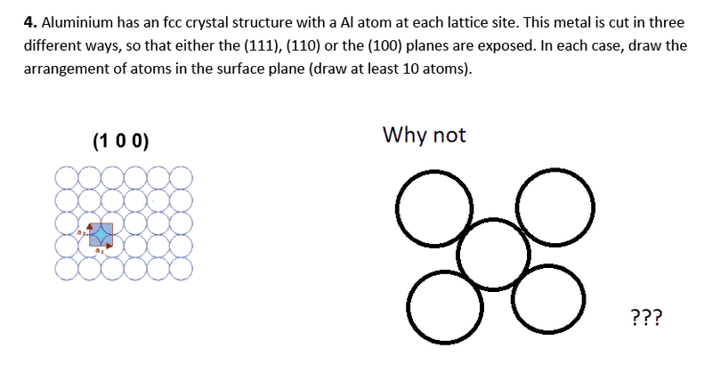

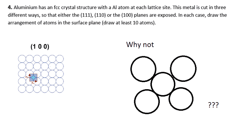

Yes. So isn't there 4 atoms at the corner and an atom in the centre of a face?haruspex said:Isn't (100) the YZ plane?
See images at https://en.m.wikipedia.org/wiki/Miller_index.
Hmm.. yes, I see what you mean.Clara Chung said:Yes. So isn't there 4 atoms at the corner and an atom in the centre of a face?
It would by all right, but you should draw at least 10 atoms.Clara Chung said:Homework Statement
Attempted in the picture
