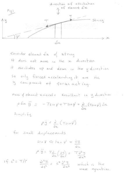

Let the string be stretched horizontally ( x axis) and plucked vertically (y axis)
If we ignore gravity then the only force acting after we have plucked the string and let go is the tension in the string.
The tension is constant in magnitude throughout the string, but since it is parallel to the tangent to the string, its direction changes from point to point. It is this change of direction that introduces actual changes within a string element dx.
If [tex]\varphi[/tex] is the angle made by the element with the x-axis at the beginning of a small element dx and ([tex]\varphi[/tex]+[tex]\delta\varphi[/tex]) at the end.
Bearing in mind that the tensions in the small element point in opposite directions at each end, the components are
Vertically
Tsin([tex]\varphi+\varphi\delta[/tex]) - Tsin([tex]\varphi[/tex])
It is this difference, which is a rotation, that provides the vertical displacement force.
Note that when [tex]\varphi[/tex] is zero the element is horizontal and sin([tex]\varphi[/tex]) is zero so there no displacement force
Horizontally
The stretching force is
Tcos([tex]\varphi+\varphi\delta[/tex]) - Tcos([tex]\varphi[/tex])
Note that when the element is horizontal T points horizontally at both ends so there is no net horizontal foce acting.
Here is a derivation of the wave equation using this information.
That made it clear about forces.
One question- When you pluck the string and let it perform oscillations (ignore external forces), the middle point of the string has maximum kinetic energy at the mean position. When it reaches the extreme position, you proved that its potential energy is 0. Where does the initial kinetic energy go then?
If you analyse other points, there is a stored potential energy due to stretching which compensates for the loss of kinetic energy.
Good question and I'm sorry I didn't answer first time.
The string is continuous so is the stretching. The PE is stored throughout the string in an uneven manner, just as the KE is distributed throughout the elements in an uneven manner.
If fact as the antinode element passes through y=zero the string is unstretched so all the PE has been returned as KE.
Similarly as the antinode element rises it slows, the whole string stretches, and the KE is converted to PE in the whole string. Eventually at the antinode the element halts and reverses, Thus the KE passes through zero and the PE is a max.
