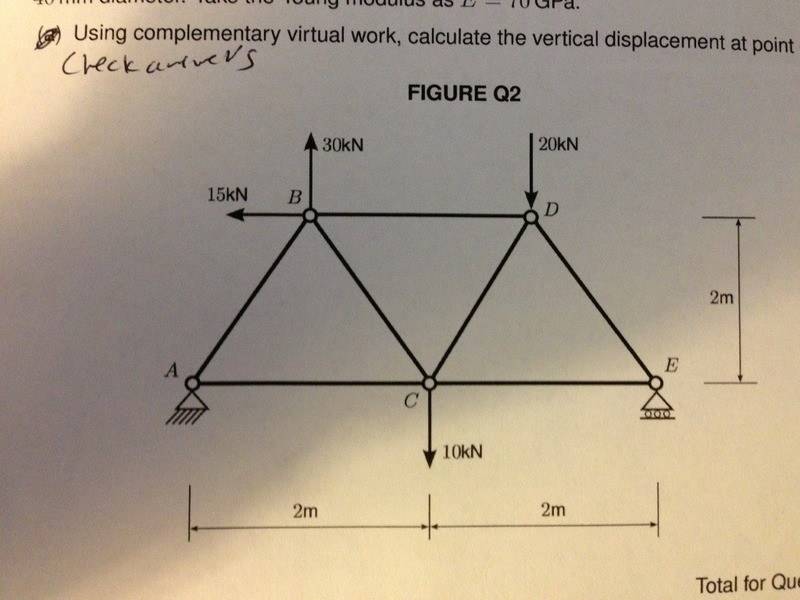

I am trying to calculate the vertical displacement at point C for the following diagram
https://www.physicsforums.com/attachments/57161
So far i have calculated the forces in each member and i now need to calculate the Virtual forces!
I applied a virtual load at point c of 1 KN.
I also know that our structure is symmetrical!
Can you please help me to continue
Thank you

I have calculated tge vertical displacement to be 0.0172 mm
