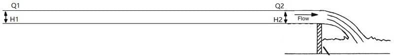

I want to know how it applies to this scenario
u have long channel without slope H1 = H2
according to above, water closer to free fall should be slower and warmer,
slower water would mean lower Q2, but that's not the case in reality since Q1=Q2
what am i missing here ?
You are missing that the water is essentially incompressible so Q2 is not slower. Viscosity causes the pressure to vary along the pipe (not flow rate), with pressure highest at the left end.
Likes vanhees71 and hutchphd
I don't understand what pressure are you talking about, its open channel flow not flow in the pipe
In that case, the viscous drag balances the along-channel component of the gravitational force on the fluid.
Unless my intuition is mistaken, there will have to be some slope to the open channel so that the gravitational head will match the pressure head that would otherwise exist in an unpitched, closed channel with a similar flow rate.
In the absence of such a slope, the water surface itself will slope downward toward the exit -- a shallower, faster moving stream toward the exit in order to maintain an equilibrium.
Likes Lnewqban and Chestermiller
What you're missing is that your premise is nonphysical. You need a slope to maintain that flow, and as jbriggs said, if your channel isn't sloped, the water surface still will be.

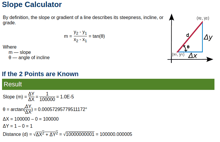

ok ,if the channel is 100km long, H1 is 1 meter H2 is zero, than slope angle along whole channel is really negligible as you can see in calculation
for 1km part of the channel, it is 100x smaller angle
so how can this molecular level slope drive the water forward
Q on 100km long channel is not 100x smaller than on 1 km channel
Q on 100km long channel is not 1000x smaller than on 0.1 km channel
1 meter drop in 100km? Your flow rate will be negligibly small. You'd effectively have a stagnant channel.
Likes jbriggs444
Likes Lnewqban
