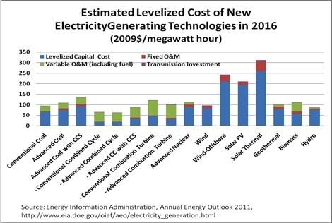

Geothermal production of energy has been tried (sometimes successfully, sometimes not) many times and is still being developed in several locations.
The problem is not physical but economic. It is far more economical to produce electricity by burning coal than almost any other way. Consequently, most alternative energy production is heavily subsidized and would not exist except for those subsidies. Whether or not these subsidies are justified is a political question, not a scientific one.
I think the days of using the superlative 'far' when comparing coal based generation costs to other generation sources are over. According to EIA at least, almost any of the combined cycle technologies, hydro of course, and now even onshore wind are on par or better with coal. And that's ignoring the costs of coal emissions (mercury, SO2, radioactivity,etc) and mining.
