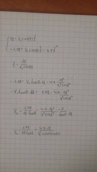

For c. that is what I did. I can't figure out what's different this time... For c. I used the horizontal equation to express time, and then I put it in the equation for the vertical direction y(x)=x0+v0t-0.5at2...

Well, in terms of the horizontal axis, we have 18=V0cos(θ)t . In c I did t= 18/cos(θ) and substituted t in the equation y(x)=x0+v0t-0.5at2 , and then I got only V0 as a variable. But in c I knew the angle. Now I have 2 variables, V0 and cos(θ)... Should I be doing something else or am I missing anything?

Well I started doing it and got some really insane equations... What exactly should I differentiate? I'm very confused.
I cannot tell where you are going wrong if you do not post your working.
Yeah you're right. I tried to separate V0 from θ, but I think I missed the entire point completely.
You need to resist the temptation to plug in numbers. Keep everything algebraic until the end. There are many advantages, not least that it makes it much easier to follow your working and spot mistakes.
Also, please do not post working as images. Take the trouble to type equations in. Guarantees legibility and makes it possible to quote individual lines in order to make comments. Images are for textbook extracts and diagrams.

One of the equations in your photo reads (assuming I am reading it correctly):
-1.98 = Votanθ(18) - (4.9)(18)2/(Vocosθ)2
That equation should be:
-1.98 = tanθ(18) - (4.9)(18)2/(Vocosθ)2
In the first term on the right-hand side of the equation, the Vo should have canceled out with the Vo from the t = 18/Vocosθ substitution - unless I'm mistaken.
And yes, as @haruspex mentioned, no calculus is necessary. You should have 3 equations: one for the x direction, and 2 for the y direction - one at the middle of the court (where the ball just clears the net) and one at the end of the court where the ball just drops in bounds. When you find the solution, please post the answer so I can check my work. :)
