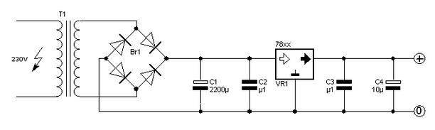

Hi,
For example, in this circuit there are two capacitors that are used to filter out low and high frequencies.
I don't see protective circuitry anywhere. At very high frenquencies, the ceramic capacitor will be source and will this damage the bridge rectifier?

I know these formulas but my assumption that the capacitor is ideal!
If the capacitor is ideal, with zero resistance, then you have only capacitative reactance XC
For ideal components, your circuit (without the diode bridge) would draw extremely large currents if you impressed a voltage on the transformer primary with a frequency in the upper RF bands. That won't happen, though, for components that are physically realizable. Foremost, the frequency response of the grid transformer will have low-pass characteristics and you'll generally have parasitic inductance just about everywhere. Maybe you've seen these types of charts before for the impedance of real capacitors as a function of frequency:

anhnha said:
Hi,
The 78xx is protected internally against DC overcurrent.
Very high frequency on incoming power lines will be attenuated by the inductance of a non-ideal (ie a real) transformer, protecting downstream parts from a source to the left..
The ceramic capacitors are there to keep the 78xx stable at high frequency. The regulator is a gain element with feedback so is capable of oscillation. Low dropout types are particularly susceptible. The ceramic capacitor keeps the regulator itself from becoming a high frequency source.
http://cds.linear.com/docs/en/application-note/an83f.pdf
http://www.analog.com/library/analogdialogue/archives/45-01/bypass_capacitors.html
http://www.ti.com/lit/an/snva167a/snva167a.pdf
