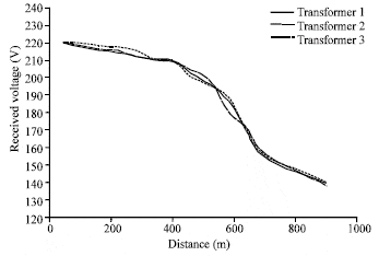

why voltage fluctuation is there?
since all the houses are in parallel,so all of them receive same voltage..then why voltage fluctuation is there? and why not current fluctuation?

You have a voltage fluctuation because the voltage source (generator/transformer) and wiring (mainly resistive losses in transmission lines) are overloaded from the current draw so the overall voltage level drops as the current increase above some level.

i have gone through the above link. in that they are telling the reason of voltage drops in transmission and distribuition lines. i think you haven't understood my question.
ok..
so, in every transmission and distribution lines there would be certain drops, reason may be the lenght,size etc. these drops would be same for all the homes which are being powered by that distribution line.
then why we use voltage stabilizer in our homes? is volatge fluctuating due to high current drawn by load?

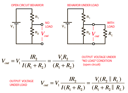

As you can see on that link the voltage drop at a home depends on it's position in the distribution line. Each segment with a house drawing a load current is a voltage divider (a length of line to it with resistance R1 and a load current with resistance R2) that depends on the load currents before in a 'voltage divider' and after it's location RL. Changes in loads before and after can effect the voltage at one location even if it's load is constant. If many homes at 400m+ on the line want to increase the voltage back to 220 using voltage stabilizers, this will draw more current from the line voltage (about 140 at the end) causing the R2 load resistance to decrease and lower the utility voltage even more along the line. The primary key to reducing voltage fluctuations in a situation like this is lowering the losses in transmission but that means spending large sums of money on basic infrastructure.
The AC power distribution system supplies a predictable voltage through a low resistance cable. The limit to the current that can be drawn is determined by the resistance of the network. If the supply voltage falls more than 5% below that specified, then more current is being drawn than the cable was designed to carry. The current drawn must be reduced, or the cable resistance reduced by using a thicker more expensive cable.

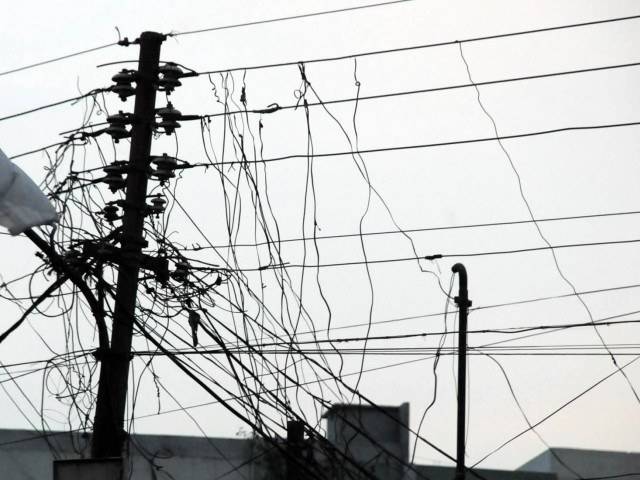

Since the power distribution is more like a tree structure than a grid, and the current drawn varies with time and location, all houses do not have the same voltage drop. There are times and places where the network is significantly overloaded due to lack of engineering, unplanned growth or energy theft.
No kidding. This is a typical power pole in some countries.

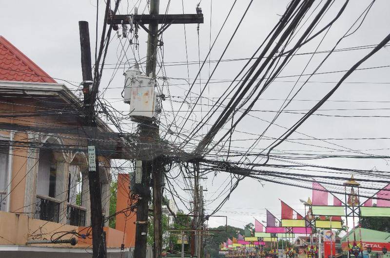

Baluncore, not all countries have stable power supplies like the USA Australia and UK to name a few
You want to try living in countries like the Philippines where my wife comes from... steady non-fluctuating mains power is but a dream. There are huge variations in supply voltage, constant brownouts and regular blackouts.
There it isn't just a good idea to have a UPS on your computer and other sensitive equip, its an essential part of life.
a pic from one of my Phil's visits
cheers
Dave

Parallel connection implies zero resistance in the wires that interconnect the circuit elements, as in top sketch of that link spook posted .
