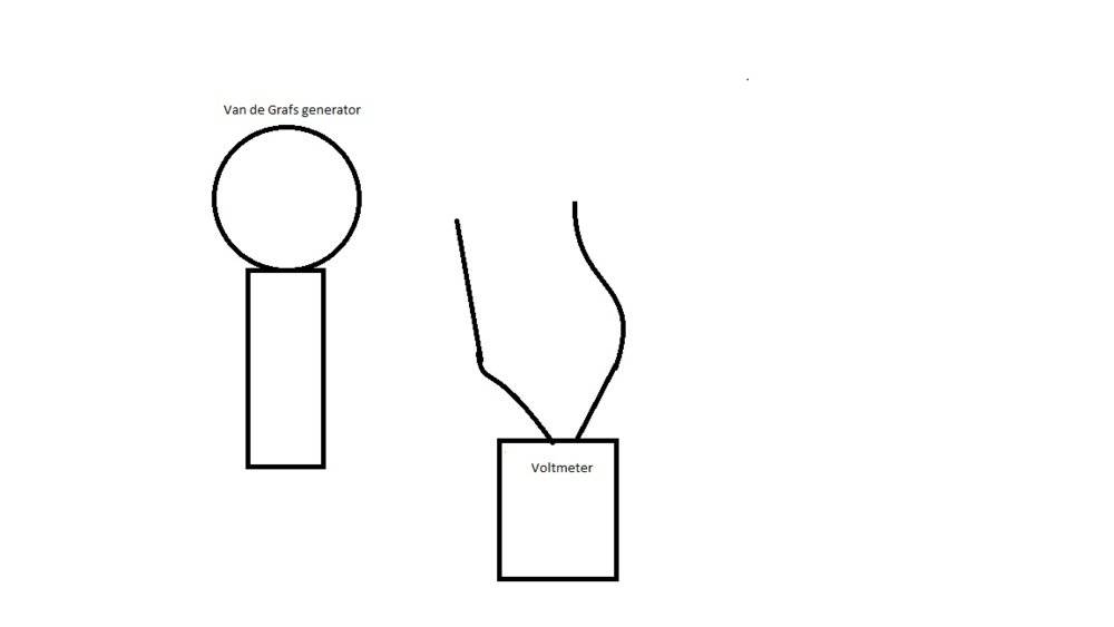

I do know the exact procedure that you do, but if I undestand correctly you say that if we have a charge on Van de Graffs generator of let say 1nC and we measure the potential using votlmeter at 1 and 5 m voltmeter would show 7V?
Not with any voltmeter I know.

Please indicate the procedure. I don't get it.
I would use a Electrostatic voltmeter to measure the VDG, though I haven't tried it myself yet.

It's often convenient to measure a voltage without passing any current if you use a 'potentiometer' circuit. You balance the test voltage against a reference voltage for zero detectable current . That way you can obtain a very high effective input resistance for the 'Voltmeter' system.
