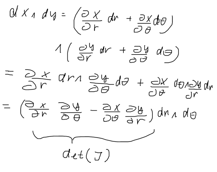

In a change of coordinate system we have ##dx^\mu = (\partial x^\mu / \partial \xi^{\kappa})d \xi^{\kappa}##, where the term in round brackets is the Jacobian. That notation implies a sum over all values that ##\kappa## can take. This don't tell us that it's an alternating sum for the case of volume element in the new coord. system, i.e. a sum where the terms have alternating sign, which is what we obtain if we resolve for the Jacobian determinant. So is there a problem with the notation on how the coordinates transform?
I'm wondering whether or not the correct would be to define the volume element by the wedge product, like ##dv = dx \wedge dy \wedge dz##, because then it gives us the correct result when we make the coordinate transformation.

Thanks. I understand what is said in these materials. What I don't understand is why the Jacobian determinant is just ##det[ \partial x^\mu / \partial \xi^\mu]## instead of ##det[ (\partial x^\mu / \partial \xi^\kappa)(\partial x^\nu / \partial \xi^\sigma)]## for the transformation ##dy^\mu dy^\nu \rightarrow dx^\sigma dx^\kappa##, as I said in post #1. As an example of what I mean, consider the transform from ##dxdy## to ##drd\theta##.

Thanks vanhees71 for your detailed reply. So the Levi-Civita tensor plays the role of the wedge product that I was thinking of before on this thread?
Yes. You can also do without a metric, i.e., with a "bare" vector space. Then covariant integration is restricted to the integration of alternating forms.
