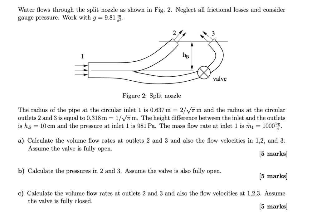

What difference does it make to the volume flow rate equation when the valve goes from open to closed?
