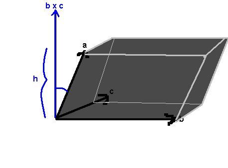

Show that the volume of a parallelepiped with edges [tex] A,B,C [/tex] is given by [tex] A \cdot (B \times C) [/tex].
[tex] B \times C [/tex] is the area of a parallelogram. From here I would I deduce the above result?
Is [tex] A [/tex] just the height?
You're right, in two dimensions x and y the area is A=|bxc|. The height is actually |a|*|cos(theta)|. Where theta is the angle between vector a, and the cross product of vectors b and c. I'll include a picture but I hope this helps analytically to prove it. V=|a dot product to (b cross product with c.
