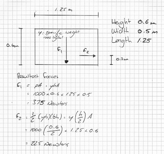

A fresh water storage tank in a factory is shown in the figure above. Its top side is denoted as C, the narrow side as B and the long side as A. In order to allow regular maintenance and cleaning side A is hinged at its bottom edge and secured using a heavy-duty clasp at its top edge. L = 1.25m, H = 0.6m & W = 0.5m
Side a has a length of 1.25m and a height of 0.6m
(Assume the density of fresh water is 1000 kg/m3 and the acceleration due to gravity is 9.81 m/s2)
a) Draw a side on view of side A (looking along arrow D) and show the size of the two forces acting on the tank side and how high they are located from the bottom of the tank
Resultant Force = Equilibrium Force in opposite direction
I've calculated the water thrust force to be 2207.25 Newtons and it's height to be 0.4m meters from the top of the box.
I am correct in assuming that water thrust force is the resultant force? and the second force being the equilibrium force?

I've redone the workings, and hope this is somewhere along the lines of being correct.
I've based my workings on the following - http://physics.usask.ca/~chang/course/ep324/lecture/lecture8.pdf
You have drawn a front view of the hinged door, not a side view (as requested in the problem statement). Please draw a side view of the hinged door, showing the force exerted by the hinge, the force exerted by the clasp, and the force exerted by the water on the door. Your calculation of F1 is correct, except that you forgot to multiply by g. I don't understand why you calculated F2, since that is not part of the problem (and I don't understand your derivation of F2). After you correct your calculation of F1, please calculate the moment of the force of the water about the hinge (please express it algebraically first).

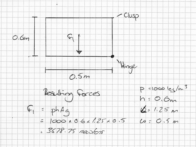

His 2nd answer is correct. His first answer doesn't seem correct. You should only be looking at the forces acting on the door. I'm still waiting to see your correctly drawn diagram of the side view of the door, showing the forces of the water, clasp, and hinge.
Hi Chester,
I believe that he is making reference to the final question which is to calculate the force required to keep the clasp shut;
a) Calculate the required resisting force at the clasp to keep the panel shut.
Amended work

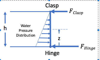

This is the figure I had in mind:
At elevation z above the hinge, the water pressure is $$p=\rho g (h-z)$$
The differential pressure force on the section of door between z and z + dz is
$$dF=pwdz=\rho g w (h-z) dz$$where w is the width of the door (1.25 m).
The differential moment of pressure force (about the hinge) on the section of the door between z and z + dz is
$$dM=pwzdz=\rho g w(h-z)zdz$$
Please integrate these equations to get the total force F and the total moment M.

This is actually very close to the way to do it.
If you integrate the water pressure distribution to get the water force F1, you get $$F_1=\rho g w\frac{h^2}{2}$$If you integrate the water pressure distribution to get the water moment M about the hinge, you get $$M=\rho g w \frac{h^3}{6}$$The distance you call D1 is the moment divided by the force: $$D_1=\frac{M}{F_1}=\frac{h}{3}$$Or, $$F_1D_1=M=\rho g w \frac{h^3}{6}$$So, now you have $$F_2D_2=\rho g w \frac{h^3}{6}$$
This gives you what you need to complete the solution (using the equations that you derived).
