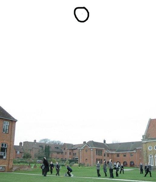

Here's one of our rockets in action. (if I uploaded the file properly!)
They sure go high!
