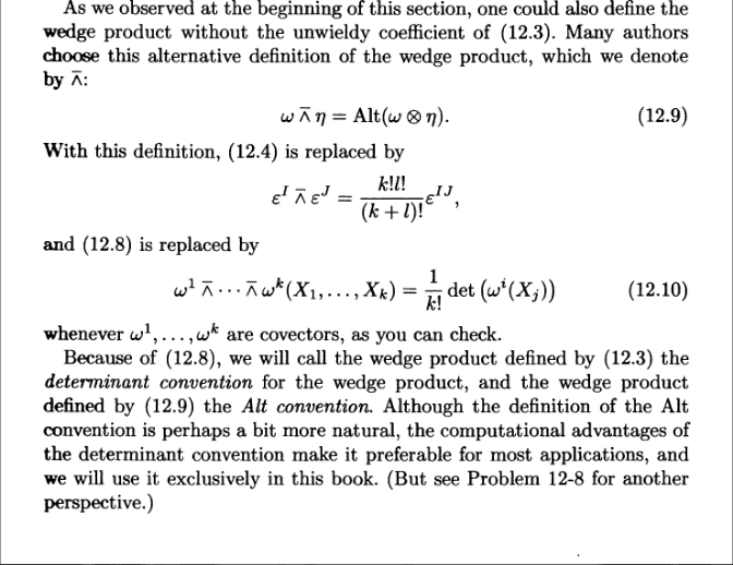

Is this a convention issue? In Lee "Smooth Manifolds", for example, the wedge product is a map ##\wedge :\Lambda ^{k}(V)\times \Lambda ^{l}(V)\rightarrow \Lambda ^{k+l}(V)## defined by ##\eta\wedge \omega = \frac{(k+l)!}{k!l!}\text{Alt}(\eta\otimes \omega)##. So in this case if ##\eta,\omega\in \Lambda ^{1}(V)## then the ##\frac{1}{2}## factor will not appear i.e. we will just get ##\eta\wedge \omega = \eta\otimes \omega-\omega\otimes \eta##. But then why in that pdf, and in this thread: https://www.physicsforums.com/showthread.php?t=150289 do they have factors of ##\frac{1}{2}##?
EDIT: Ok micromass just told me that it's a conventional issue in the definition. There is another convention where the ##\frac{1}{2}## does come in. See page 302 of Lee "Smooth Manifolds".

His answer isn't wrong. He simply uses a different convention. Many authors use the convention
[tex]\omega\wedge \eta = Alt(\omega \otimes \eta)[/tex]
This is called the determinant convention, for example the paper wbn linked uses it.
Other authors, like Lee, use the Alt convention:
[tex]\omega\wedge \eta = \frac{(k+l)!}{k! l!}Alt(\omega \otimes \eta)[/tex]
I guess it doesn't matter as long as you are consistent.

Here's the relevant section in Lee, by the way, if you're interested:
